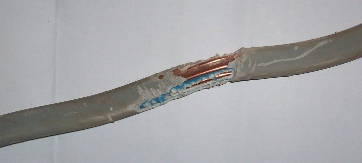

I can but assume that the cable must have got quite severely 'twisted' since, when the conductors are in their 'normal' relative positions, small deficiencies in insulation will not result in any of them coming into copper-to-copper contact. As one might expect, this rodent-attacked cable (which I suspect is probably far worse than your 'small breach of the insulation on the N') IRd fine, but had I 'severely twisted it', then two (or all three) of the conductors could well have come into copper-to-copper contact ...
Kind Regards, John
Looks like fried mouse for dinner there!
I assume if the pin is still in the pin hole then it could give a decent short, although I'm not sure how many pinholes are actually made by pins nowadays.
One might think so, but there were no nearby corpses, even skeletal ones!
I'm sure you're right - but I also doubt that there was still a 'pin' in the 'pinhole' that secure reported!
