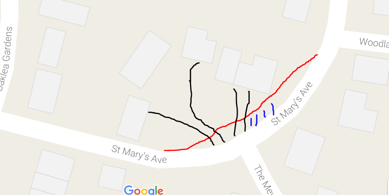

The sight line cuts across two driveways and is our exit onto the estate road across dropped kerbs. Apart from us pulling out into the road the council guy a few years said it was also intended to give cars driving around the curve in the road clear site of any oncoming cars.There is a , cul de sac, junction/exit on the other side of the road so not directly affected as they have clear view anyway
This is what it looks like
Red is the marked "line of sight"
Black are the driveways and blue is where he is considering as a parking area. According to the plans he owns that area...
Remembering this is not a main road but an estate road

Looking at my deeds the red line is in fact dotted which is a boundary on the plan so they don't own that part but the council does unless its some sort of joint ownership. I called the council because the kerb drop was in that area. I'm beginning to suspect as I say that they don't actually own that land as they seem to think. Although the previous owners paid the council to cut the grass along that area to the side so I'm not sure now.Weird
