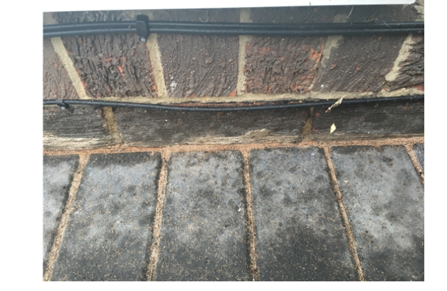

shows blocks and gaps (also DPC which is only 1 brick

Seems like BP wasn't the best choice here or it should have been permeable!
The Planning requirement for a porous solution / run off within the site, is to avoid rain running off on to the pavement and road, as this can contribute to flooding in extreme conditions. Where you run it to within the site, e.g. into the house drain, is of no concern. Sounds like you might be ok re Planning.
