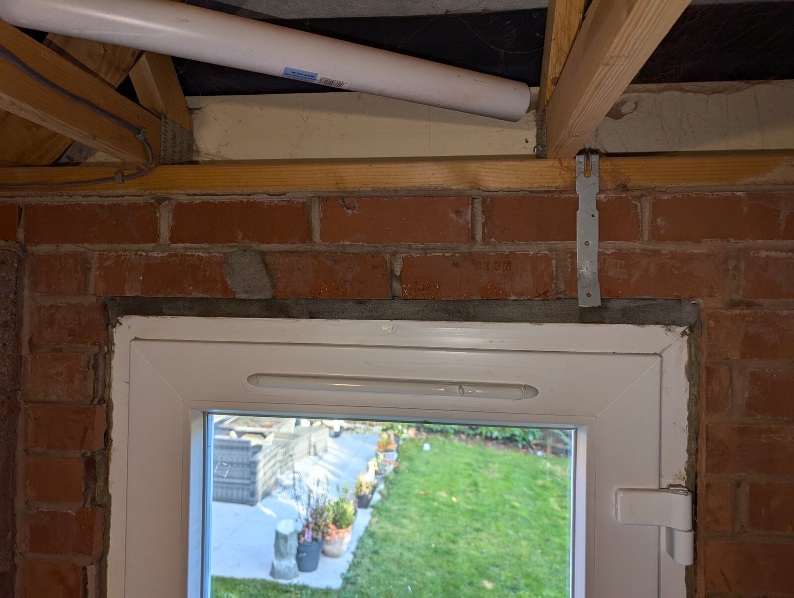

Hi there,
I recently had a door put into a single skin garage (new build).
The chap didn't use a lintel, should he have? There are two rows of bricks above, see image.
Advice appreciated,

If it had just been 2 courses of bricks you might have got away with it - although it wouldn’t be right.
With the roof trusses sitting above as well, I’d be wanting a lintel.
Not the best way to do things, but my workshop has had the same forever and nothing has moved.
The door frame acts as a lintel, although not ideal.
