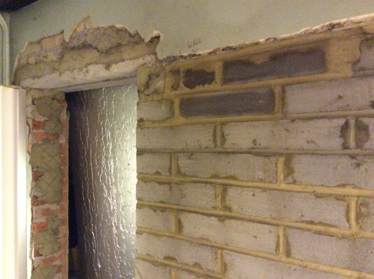

hi fellas
Does this look right to you. Its the external wall to the house, builder had taken a window out and put in a couple of lintels, but it looks to me like he has blocked up and supporting the lintel on the right hand side with breeze blocks, are these too soft, should it be concrete blocks
Ta muchley
Why would they sell soft blocks if you can't build with them and put lintels and floors and roofs on them?
They look like AAC blocks which are OK to use for a bearing, although you would normally lay them doubled up instead of single coursed, and concrete blocks are better for rendering on an external wall.

Tbh, that bit of wall does not look too bad. It seems nicely laid and he's made a good effort to keep it presentable. I'm not sure I would have bothered so much knowing it would be plastered. :rolleyes:. But yes, you are right to question the more important things, as those are what matter.
His bricky was descent, unfortunately the guy running the job is either incompetent or just doesn't give a monkeys
