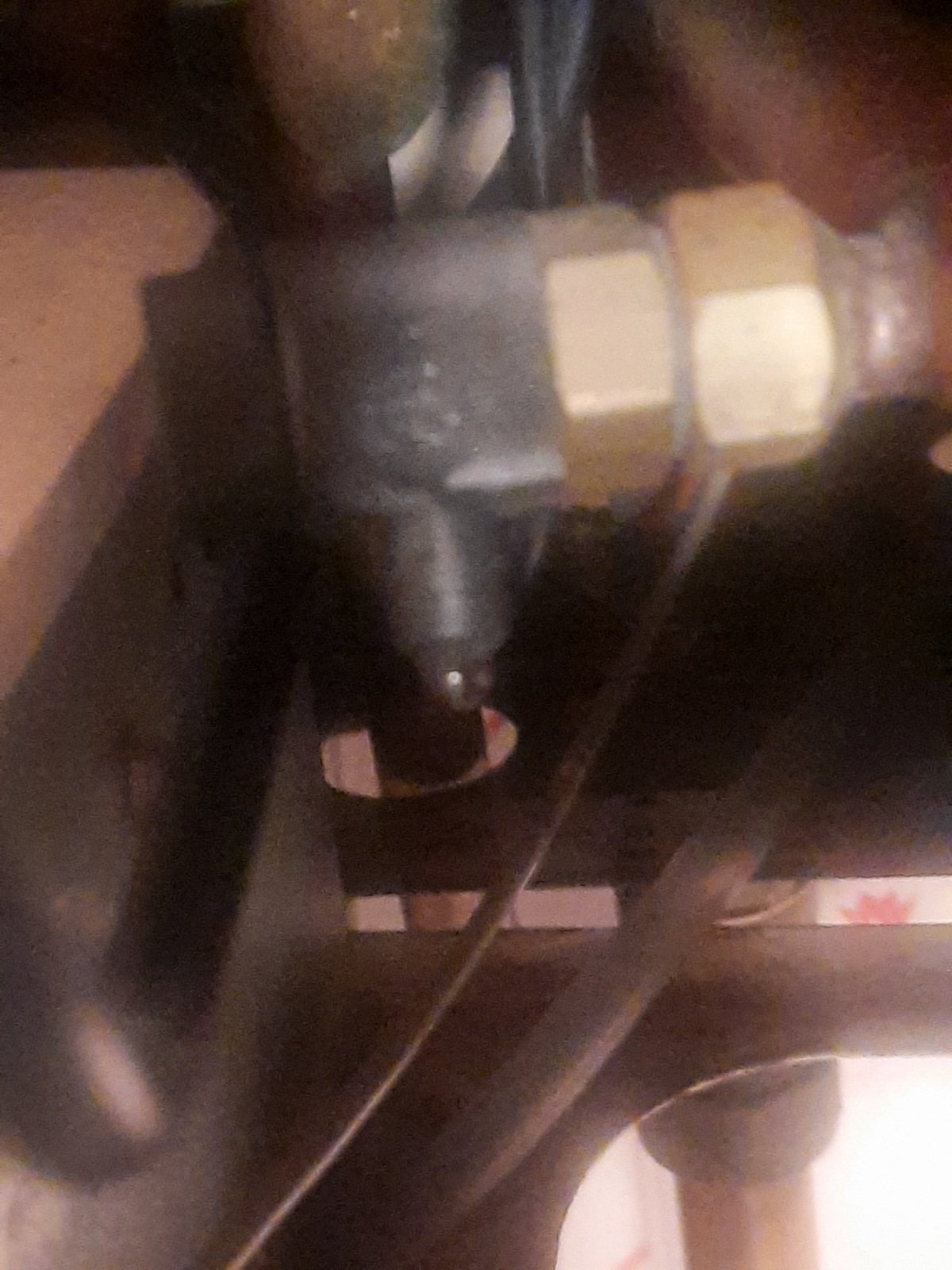

Noticed a little pool of water underneath my boiler after I had switched the boiler off for a few hours and have now identified the leak's source (see attachments provided). It really is only the tiniest of drips but I don't things to ge any worse. I feel a little embarrassed about getting an engineer round for something like this, however, I don't want to start messing about and potentially make murders worse. Looks like little pipe coming from pump, possibly, bolts needing tightened? No leaking when boiler is on (which will be due to heat expansion, I should imagine, although I am no expert).

Yeah, I was just looking for a way to compress the video I took as this gives best indication. Here is a pic for now.

Looks like a drain off, not the best photo, but the left hand nut should be able to tighten slightly, using water pump pliers or similar
Ok, will do. I was thinking that might be all it could be needing, but, as I am no DIY expert, I was apprehensive. Does slight slackening sometimes happen through use?
Not slackening of the nut, no, but heat and cold = expansion and contraction of parts, which can cause leaks.
