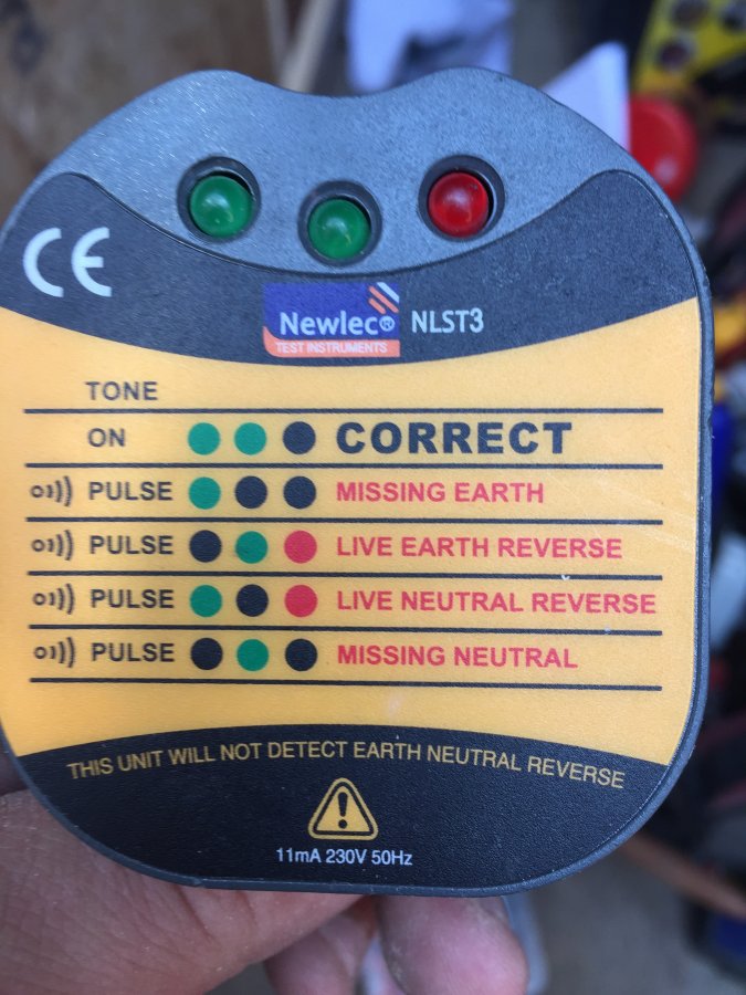

Live neutral reverse
Socket tester gives all other outlets in the house all clear
So I'm assuming that the circuit is at fault unless the tester has a mind of its own and is taking the **** out of me
There is a fault, but not necessarily reversed polarity.
Those plug in socket testers can give very misleading results, particularly when the fault is not one of those listed on the front of the device.
I vaquely recall getting reverse polarity showing once, I think it turned out to be a poor earth, im quessing the electronics could not decide, due to the poor earth. if the circuit was ok, or that was no earth present, thus opting for reverse polarity.
I would get a second opinion using a 2 pole voltage tester
I vaquely recall getting reverse polarity showing once, I think it turned out to be a poor earth, im quessing the electronics could not decide, due to the poor earth. if the circuit was ok, or that was no earth present, thus opting for reverse polarity. ... I would get a second opinion using a 2 pole voltage tester
Maybe - I certainly agree these plug-in testers can sometimes give odd results with 'unusual' faults, so that a second opinion from different kit would be advisable. Having said that, I would have thought that reverse polarity was probably one of the easier things to detect, requiring (as well as other things) something approaching full supply voltage to appear between neutral and earth (so seemingly unlikely to be caused by a 'poor earth').

Given that one of the faults they can't detect is a neutral earth cross, is this another source of incorrect indication?
I haven't thought all that deeply, but, at first sight, I can't really see how any sort of plug-in tester could possibly detect a N-E reversal, particularly in a TN-C-S installation, where the two are joined at the cutout. Indeed, other than end-to-end continuity tests on a disconnected circuit, I'm not sure how any sort of testing could detect it in a TN-C-S installation (and not necessarily that easy with TN-S).

If it was a missing earth shouldn't this tester pick that up and not just guess at L N reverse
