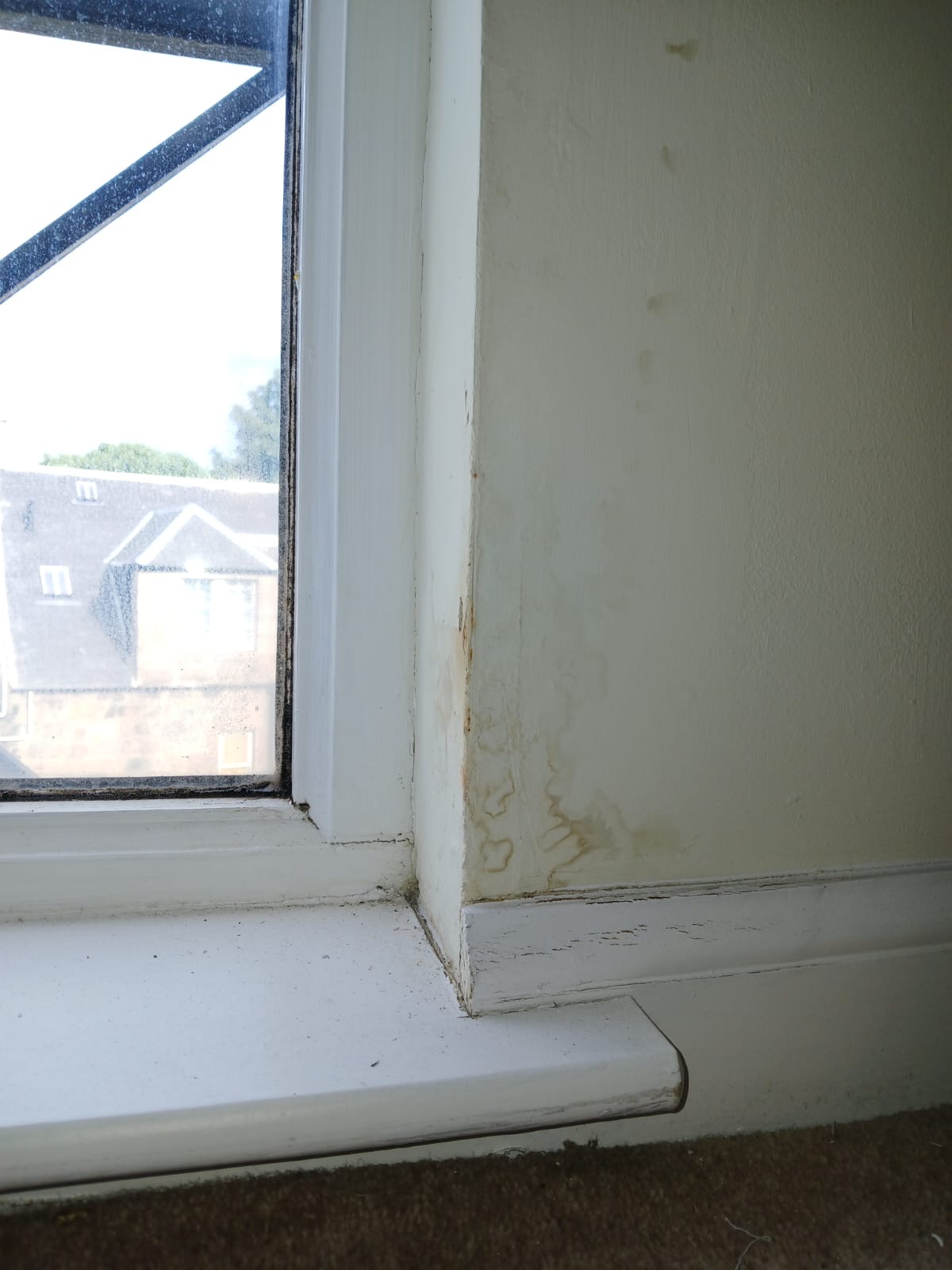

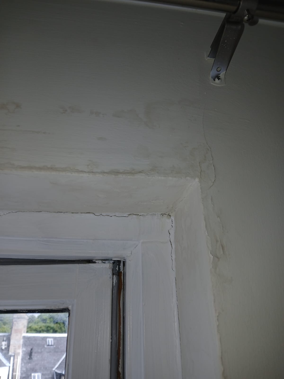

Moved into property and small issue at the window as you can see from the pictures old damp or rot I am unsure what it is.

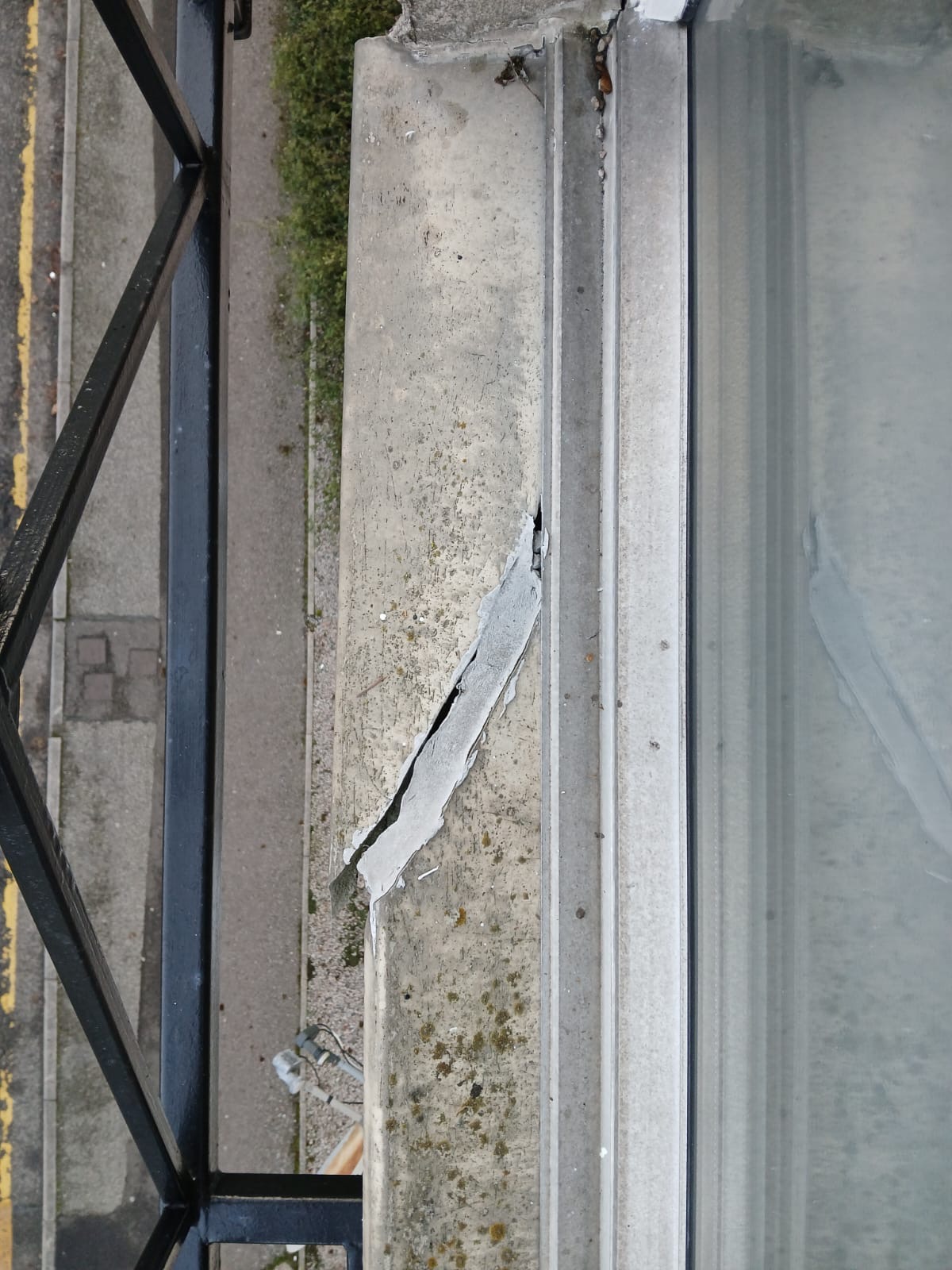

When it rains water occasionally comes in through the old wooden window and you can also see from the picture that outside the building there is a crack to the window ledge that only my apartment has, all other properties in the block do not have this problem.

You have active penetrating damp below, on the right & above the opening.
The rail in pic 1. is beginning to rot.

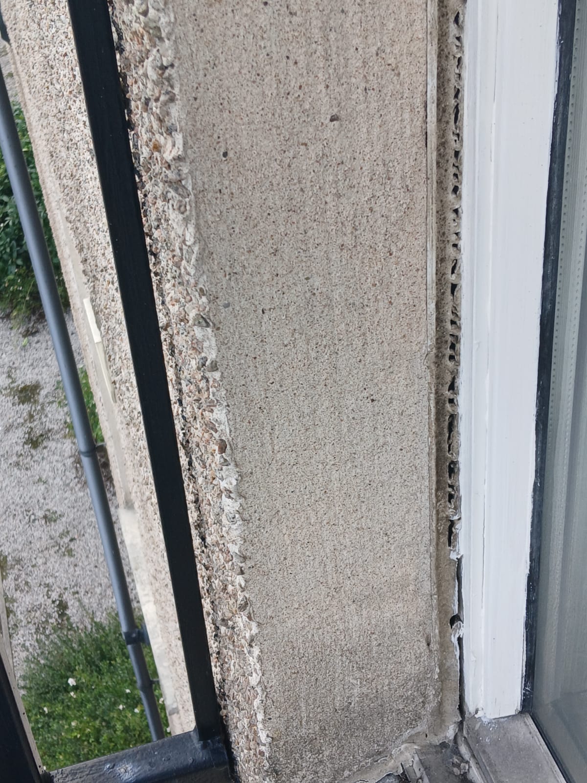

Pics showing the out side of the opening & the sill are needed.

eg. the interior will require all signs of rot or damp removed back to brickwork or studs.

With the window open you could use a selfie stick to safely take pics from around the outside of the opening.

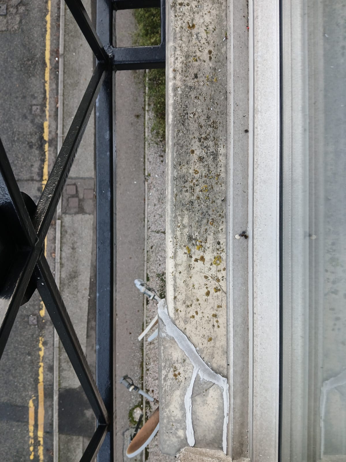

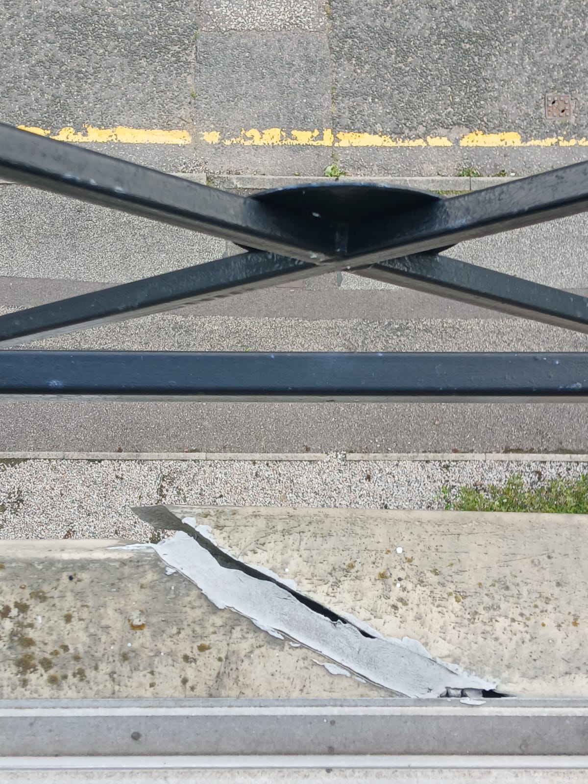

Its obvious that the window sill is split - it was obvious in the first pics.
There's very poor sealant showing but the pic shows only one small area of the surround.
So without pics showing much more of the outside I'm afraid I cant help you anymore.
