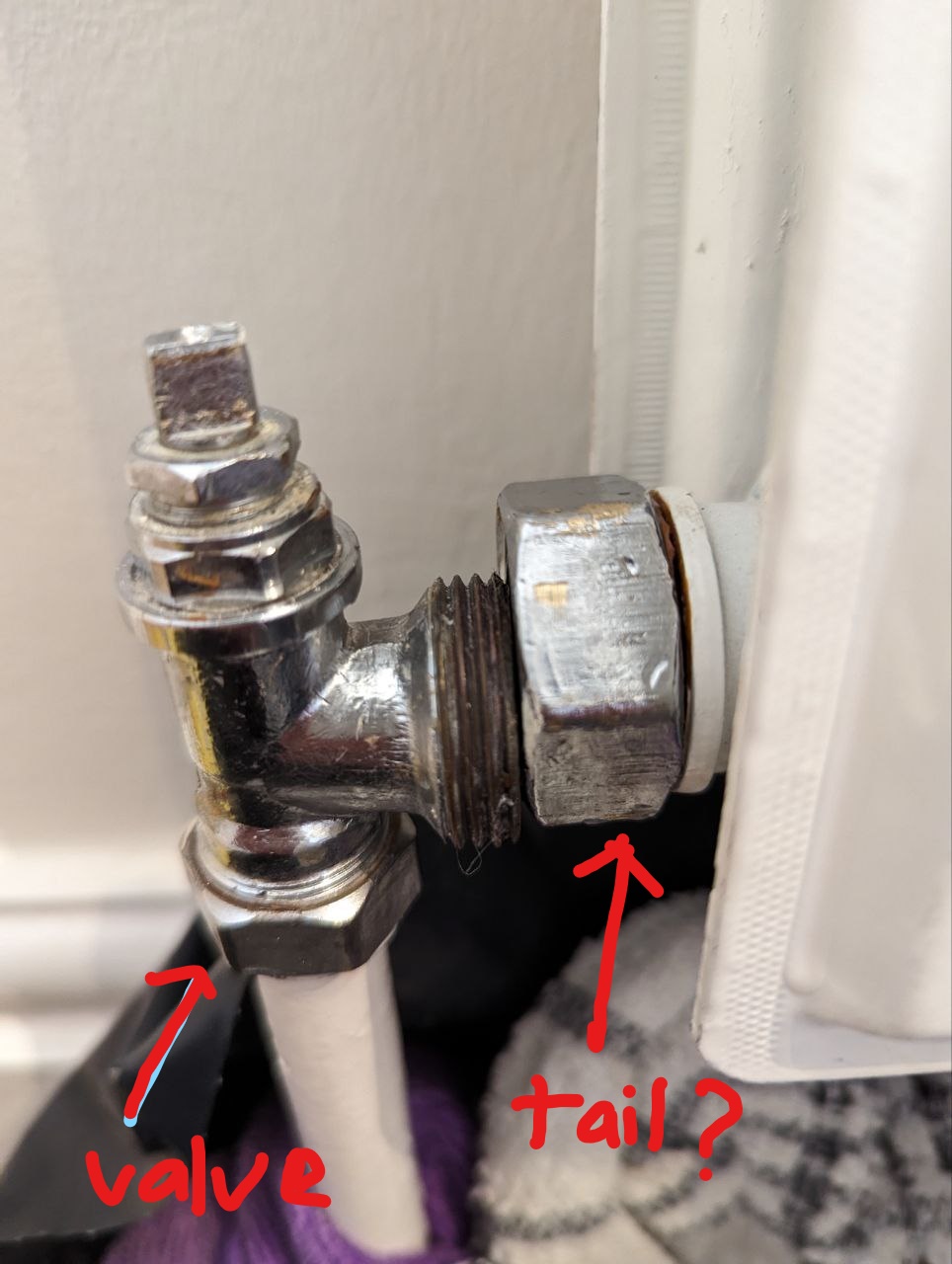

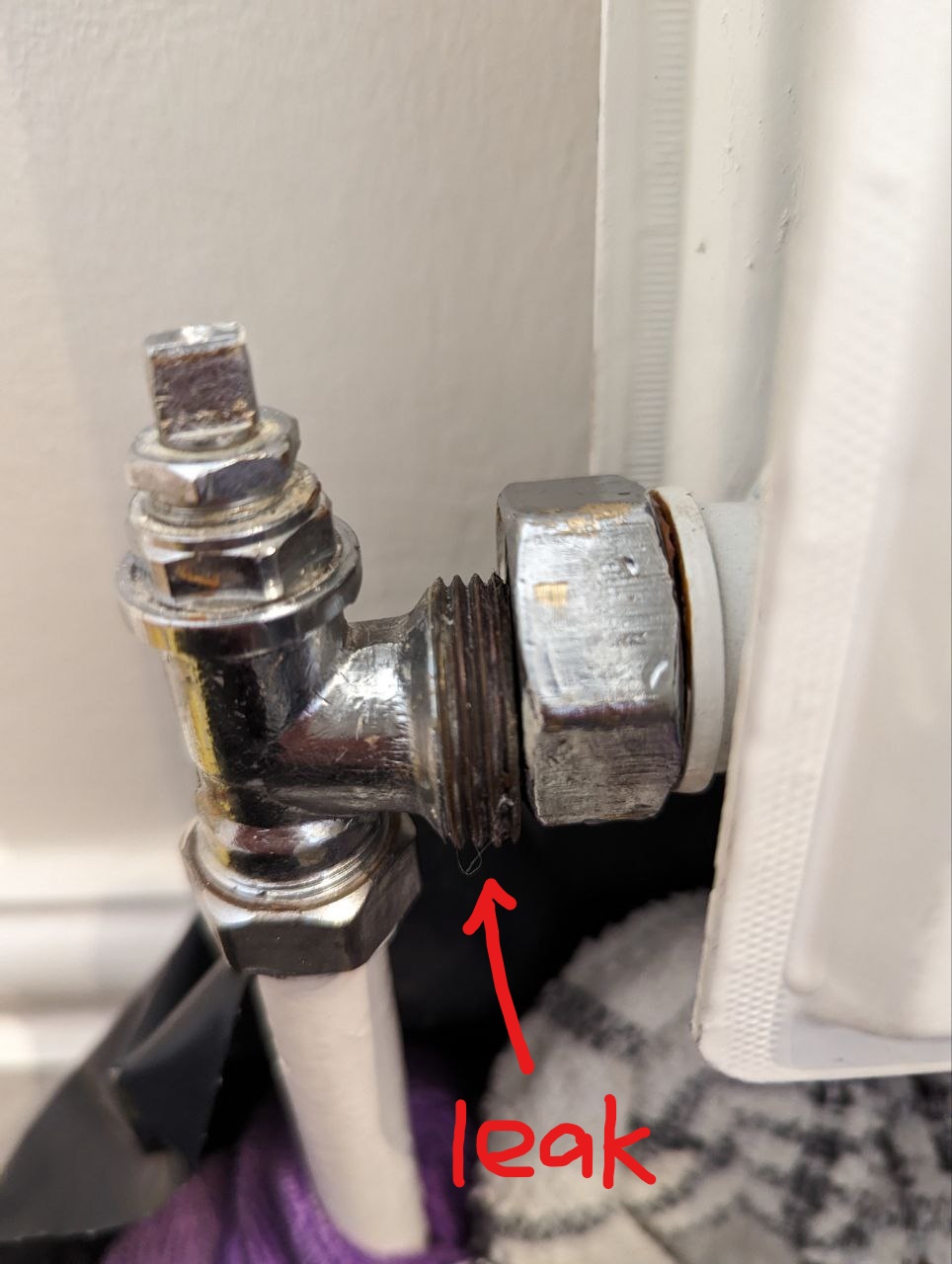

Hello, to do some plastering work, I've isolated and drained one radiator from my pressurised central heating system with combi boiler.
After reconnecting it and re-pressurising however, the lockshield valve is leaking at the connection to the radiator.

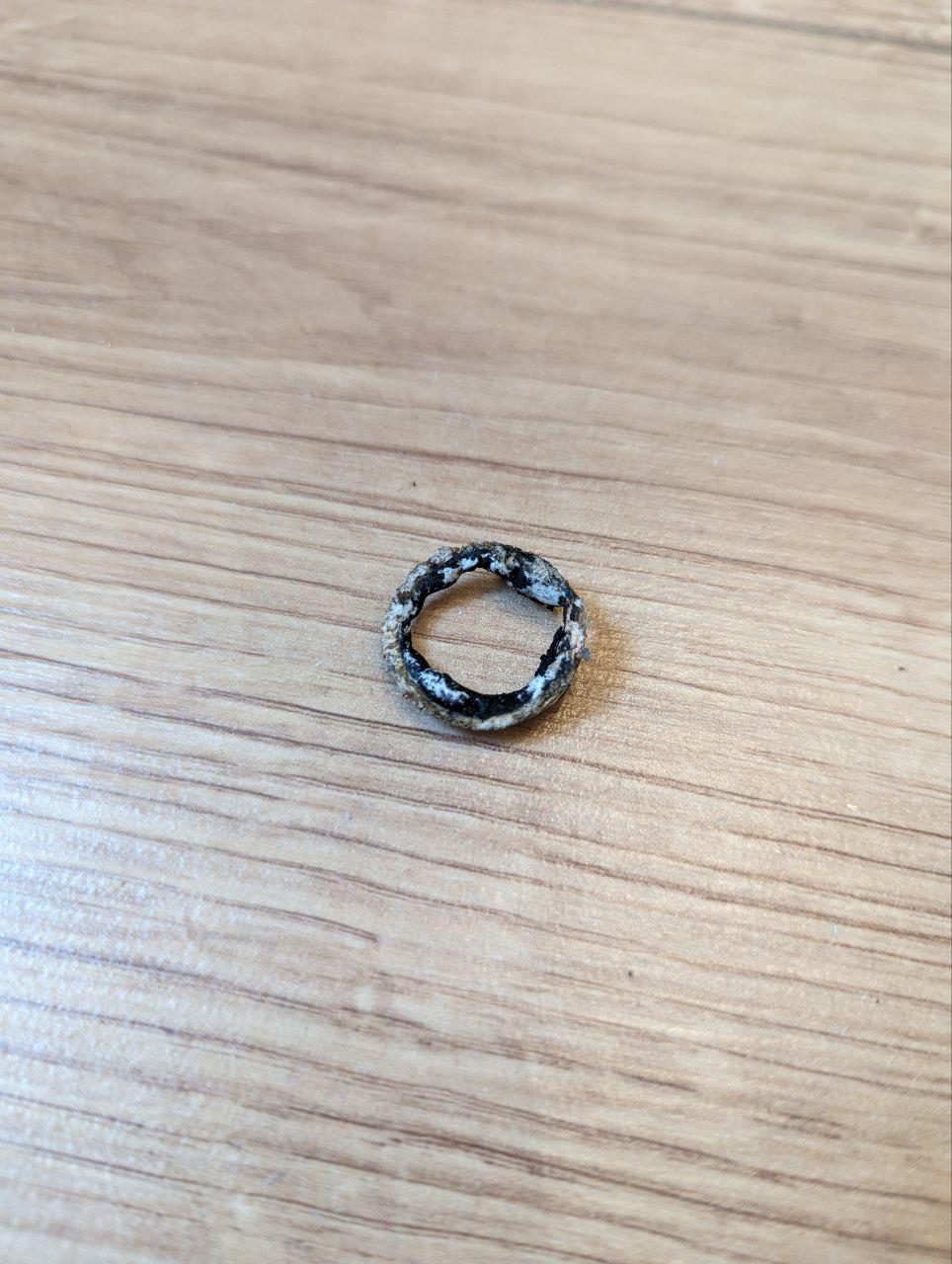

I removed it again and noticed this old O ring from within the valve.
Questions:
1. Is the O ring the reason for the leak?
2. If so, do I replace the valve or O ring? I can't seem to find like-for-like replacements for either, as the diameter for the thread is approx. 1 inch

If it’s an o-ring rather than an olive to seal, then yes, you’ll need a replacement O-ring.
Do you mean copper compression olives? I've run a finger into the valve and there isn't anything else in there other than this deformed rubber ring
Doesn’t matter the material, as you can get brass olives. As per @Bod ... obtaining a replacement could prove tricky, probably best replacing the valve/tail set.
I'll try out these assorted sizes rings. I'm not quite sure if it's 18mm or 20mm diameter as it's so deformed.
Do I need to replace the radiator as well? I can't seem to find a similar sized valve to this seemingly very old one.
Not at all.

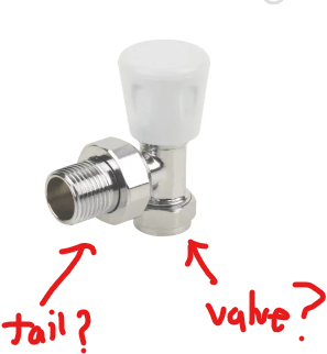

The tail should be 1/2” so it doesn’t matter if you replace it with a 3/4” x 1/2” or 1/2” alone, as long as the dimensions are similar. You may need a radiator Allen key to remove though, not expensive either.

Not at all.
Screwfix
Am I right in understanding that buying a new valve also includes the tail (as annotated in picture)?
So to get this working, I need to remove the existing valve from the pipe, and existing tail from the radiator?
The pressure in the loop is about 0.5 bars now, would I need to drain down the whole loop to replace the valve/tail?
I've seen a few videos where draining down isn't required to replace TRVs, I would think it's the same for replacing a lockshield valve.
