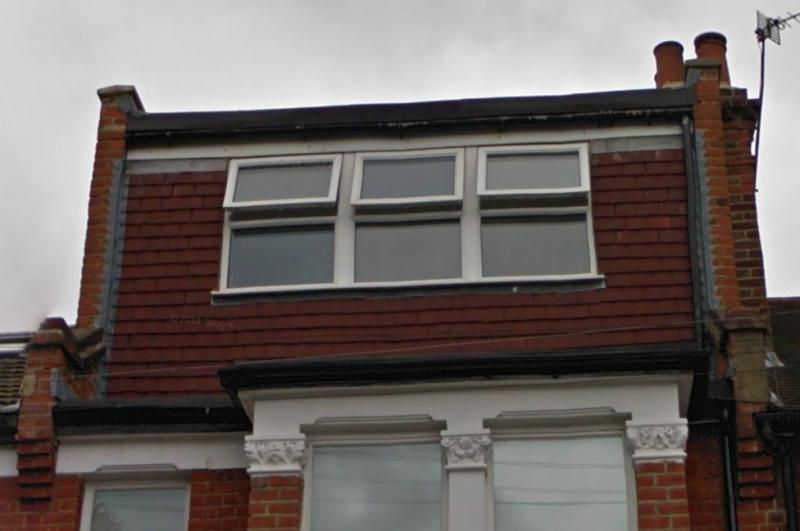

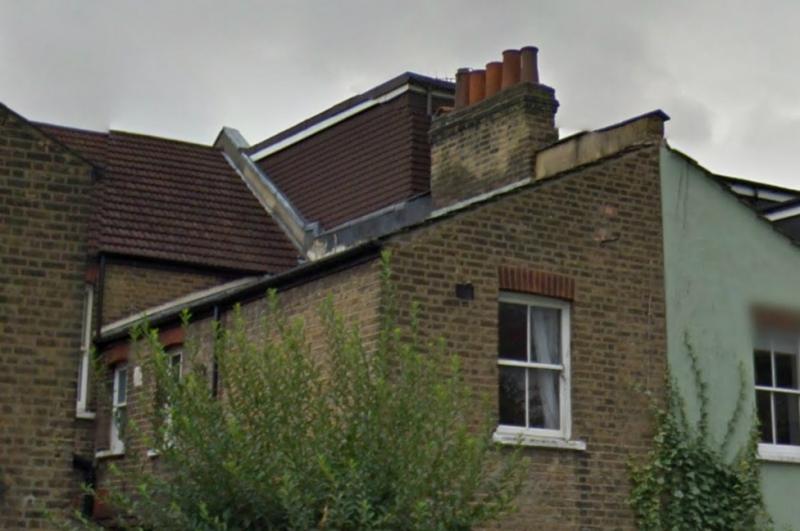

As far as full width extensions are concerned, I find it staggering that present policy allows the following in terraces...
Instead, I think it should be a requirement that the Party Wall is raised to the full height of the extension...
Is the bottom pic showing the front elevation of a house? (looks that way with the fancy windows). If so, surely they must have had p.p.for that?
Ah - yes - I understand your point.
Problem with our LPA is that if we build off the party wall, they refuse to accept it as pd, because they say that it is not 'development within the curtilage', ie the dormer goes over the boundary.
Probably could be appealed, but few clients are prepared to hold up the work
for the sake of a few extra inches on the width.
I'm not sure that you do understand my point. Both dormers are exactly the same width (internally). The difference is simply the treatment at the party wall.
Your LPA is sharper than most. Around here, they wouldn't even notice.
