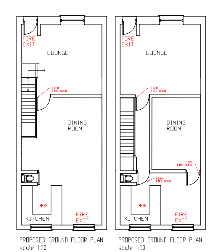

Personally I think that layout would be a 'fail' because you've taken up nearly half the first floor with circulation space.
Ideally, you put the loft stairs over the existing stairs to save space.
Agreed though then it seems he'll lose his family bathroom on 1st flr level, though his current proposal doesn't seem to work anyway due to the lack of headroom - see previous post.
The first floor layout was unchanged from the OP's plan.
All I changed was the ground floor by switching the stairs around so they start from the front of the house instead of the back.
Saves the OP from building a corridor from the bottom of the stairs to an exit and losing downstairs space
Mine on the left, OP's on the right
