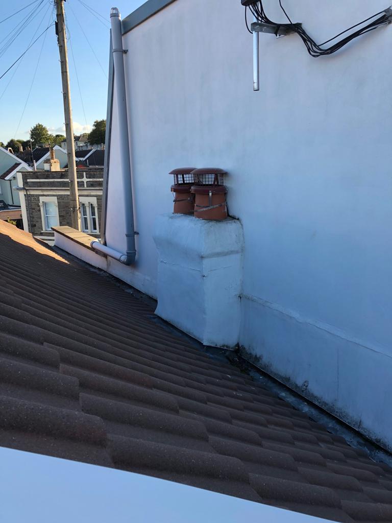

A loft extension was built next door in 2013, we moved into our home in 2017 and have recently had a survey to get a log burner fitted only to find the loft extension next door is blocking our chimney which now sits half way up their wall and we will need to extend to above their roof costing approx £1k. From reviewing their building plans, they do include moving existing chimney to sit above roof height (but I assume this was only their chinmey as ours was left in situ)
Can anyone advise what rights we have? Are they liable to fix this?

Unfortunately it’s only just come to light. When we bought the house the surveyor didn’t go up on the roof.
I suppose you could tell them to remove the soil vent pipe and satellite dish, as a retaliatory gesture.
Should the pipe and dish not be there? Is that side of the wall classed as mine?
I’m hoping when extending the chimney I can fix it to the wall (hope the neighbours will allow it since they have caused the issue) otherwise they can put support in place on my roof
I'm not so sure. Unless they had written permission to effectively render the chimneys redundant I would think the neighbour is on a sticky wicket and I would like to think it is still actionable. Just because no one noticed for 5 years doesn't make it OK. Similarly the trespass caused by the soil and vent pipe and the satelite dish. I've got a funny feeling there is no cut off date for party wall disputes but I could well be wrong on that.
If the original plans said "move existing chimney" I would take that to be the whole chimney for both properties not just the half on the neighbour's side.

I assumed they had raised the existing party wall?
Yes that’s right, they previously had a roof similar to ours and they put the wall in when extending into the loft.

"done everything they should have and acted in good faith"! Have you seen the photo? I'm just surprised they didn't put a door in that wall and build a roof terrace complete with hot tub and bar. Honestly the bare faced cheek of some people.
I doubt they've ever been up there. Just followed the advice of their designer, pw surveyor, and builder. Posted cheques when supposed to etc.
