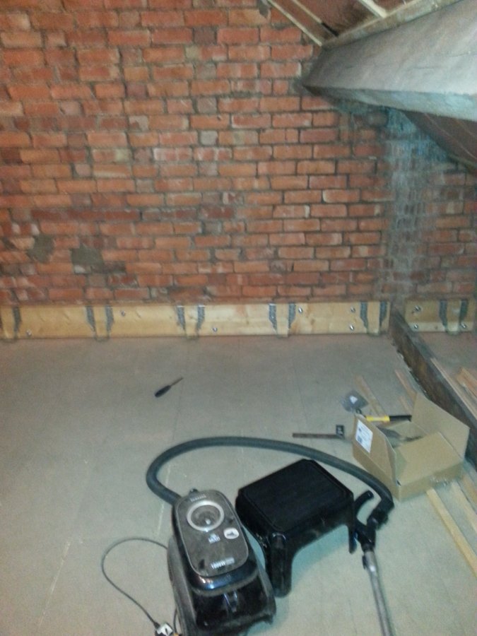

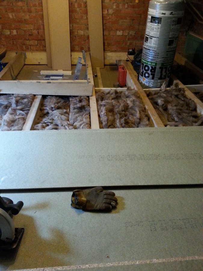

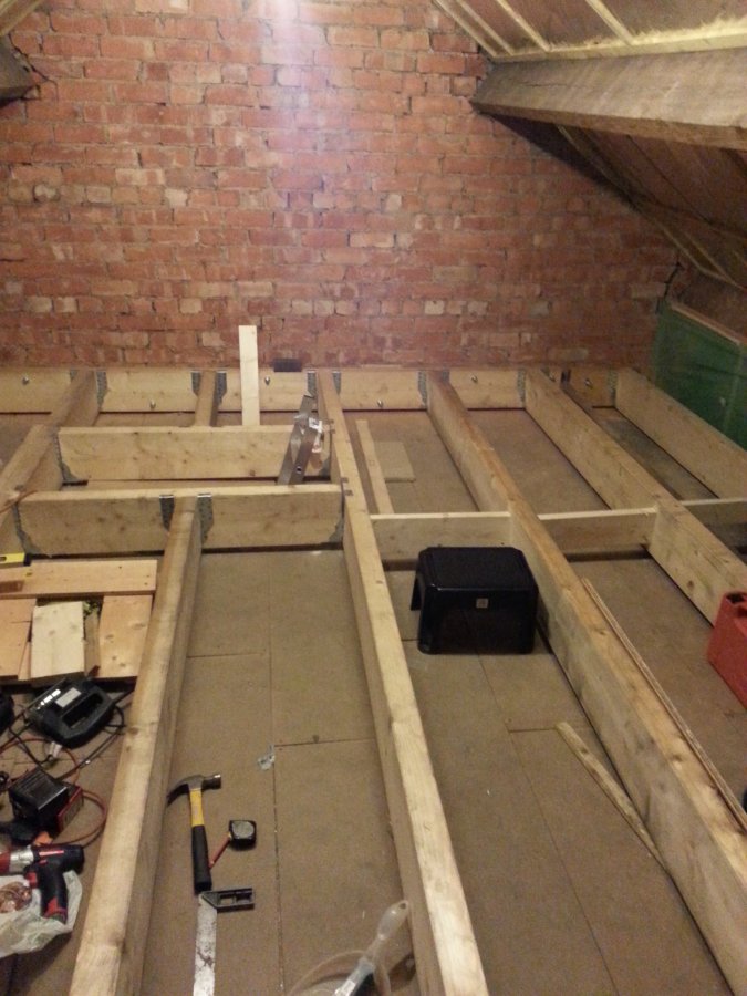

update.........i decided to fix two timber wall plates to each gable end (220mm x 75mm c24) with 190mm 12mm diameter steel bolts which were fixed into the wall using chemical resins and then fixed timbers in 1 piece (5m x 220mm x 75mm c24)to span the full length, I got the timbers into the loft by cutting a slot near the loft hatch to get them in, to lift the timbers up from ground level to loft I used a winch that i bought for £70.......best money I have ever spent.......i have included some pics
