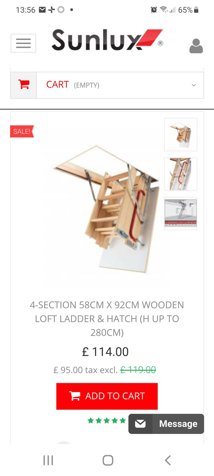

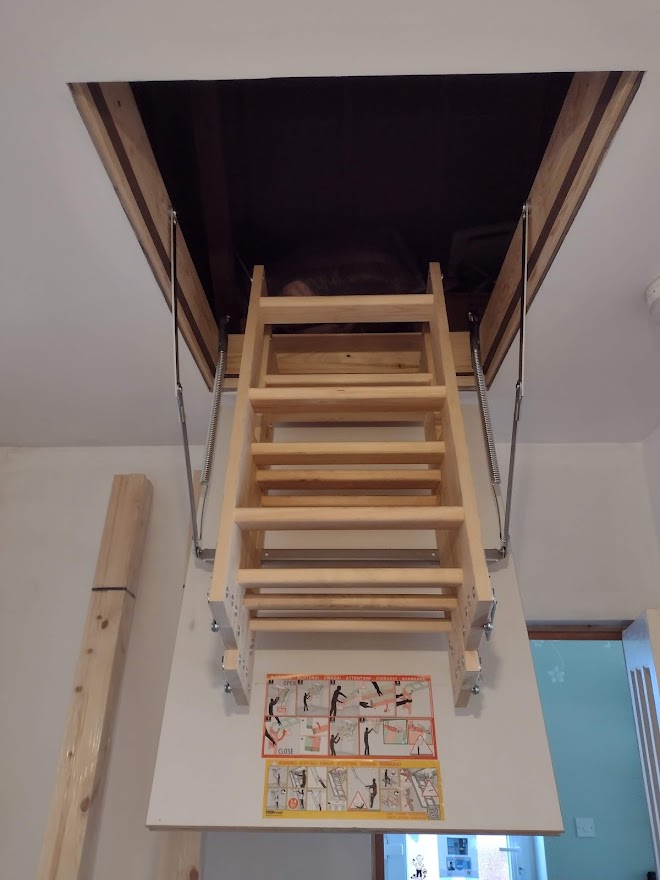

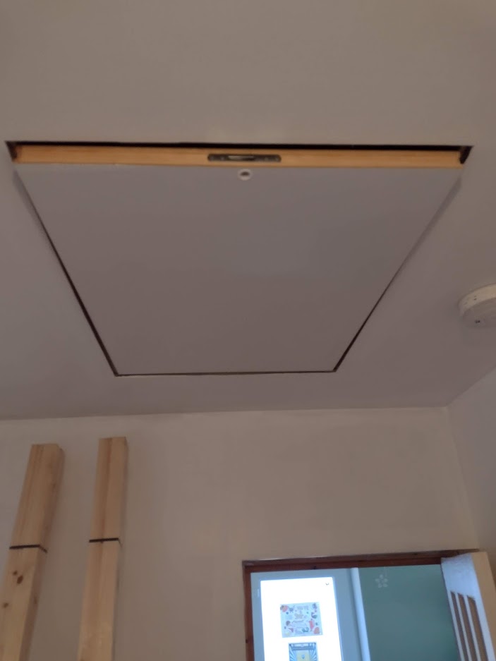

Here's mine - spring loaded, so once unlocked it just drops a little, then easy to pull down.
I how high up is it approximately?
mine is 2.5m, but they go to 2.8m - you have to cut off the bottom of the ladder.
They do lots of sizes so you should get something that fits - I had to pad out with a few old 20mm floorboards
Sorry I meant the stacked height, looks about 2 foot?.
I think I can make one of those work in our existing hatch hole
Ah, I see. No, a lot less than 2 feet. Will measure in a minute ...
Just under 15 inches
