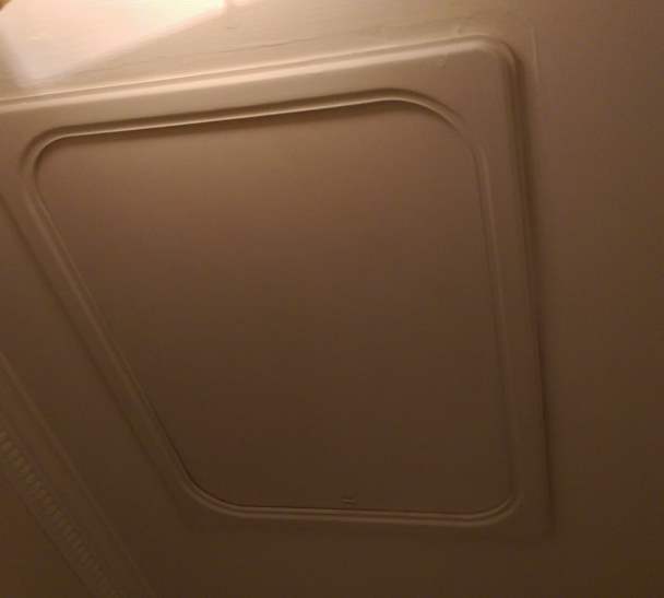

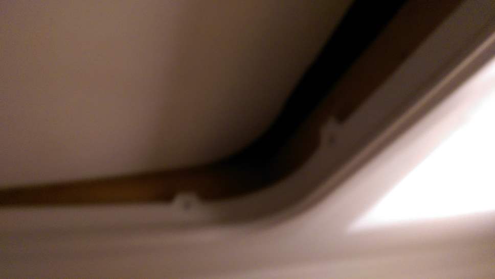

Cheers, but I don’t think I’m explaining myself (nothing new there…) what I mean is, at the moment, there’s a kind of plastic flange in the ceiling around the trapdoor opening, and the door just sits on that, to stop it dropping down into the hall.
To open the loft, I just lift the trapdoor up out of where it sits (it isn't attached, though there is a catch at one end), and set it over to one side, then climb through.
For the door to be able to swing down, I guess the plastic flange would have to be removed, which looks like it would leave at least a mess, at worst a draughty gap round the edge…?
Sorry Roger, but I did understand you, so possibly, you didn't understand me. You've got the push up and remove flap type, rather than the hinged at the back drop down type, but it's immaterial at the end of the day. In both cases, you need to make sure that when you fit the ladder, it can come down and miss the lip of the hatch. Come back when you get round to fitting it and we'll help from there.
AAAAAHHH, the penny's dropped - you mean I'd leave my loft door the way it is. That wouldn't work for me I'm afraid... to open the door, I'd have to get a chair to stand on, lift the door into the attic, then put the chair away and pull the ladder down...
I'll have to have a think.
Then you need to replace it with a drop down hinged one, that has a pole to unlock it, but is there much difference in the size. Think about the wooden one then; you pull the trap door down, and it brings the ladder with it.
