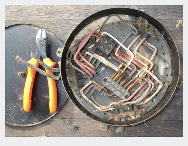

Terminal blocks (with screws) should not be used if they are not accessible. Maintenance free boxes are now used.
Junction boxes are - these days - not used for new installations, but of course decades of work by householders snd sundry trades may make an installation into a spaghetti nightmare.
Way back when, house lighting wiring was installed using a multi-way junction box hidden usually under the landing floor and in the loft. Always a nightmare to find these. Here’s one I prepared earlier!
That looks a nightmare!
