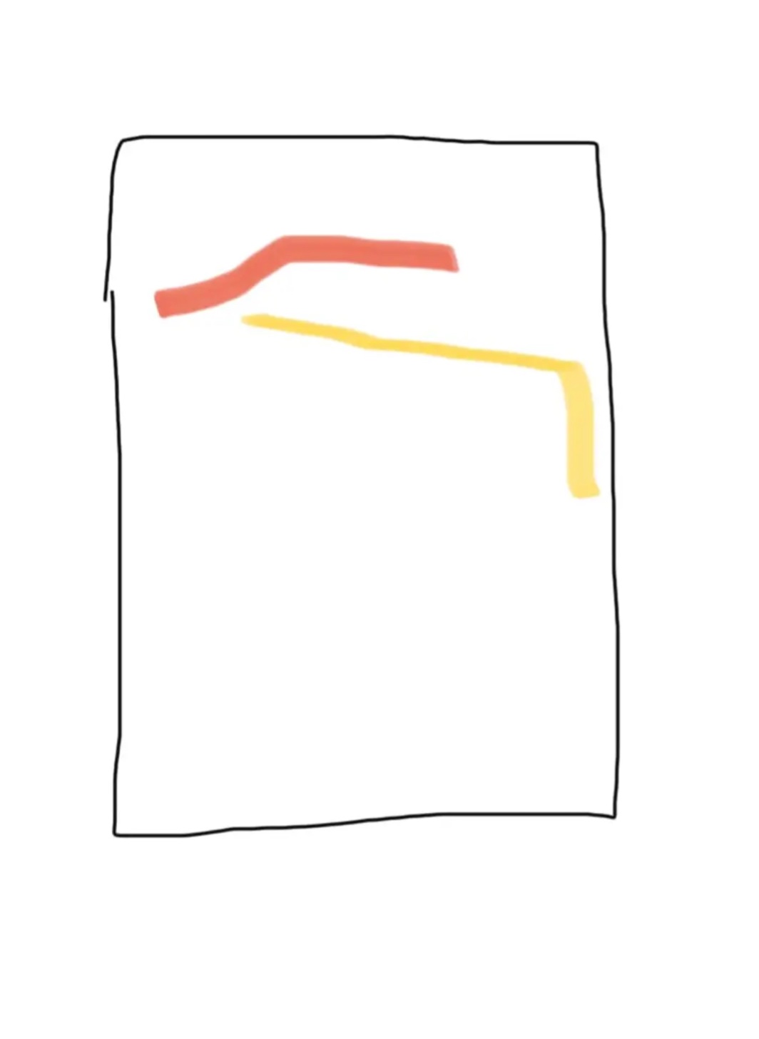

I have ran wood burning stoves for 10 years and had no problems. I've always had the flue swept and inspected once or twice yearly and I only burn dry timber.
I decided to swap my old stoves for two new DEFRA wood burners as they are slightly larger and more efficient. I also had new 5" liners installed (recommended size for these stoves). The height of the flues is 9 metres straight up to an open pot with a 'bird cage' on the top.
I now have problems with getting a good draw. I can just about stop smoke entering the room during reloading, but it's a bit of an art and I notice that the draw isn't particularly strong. I also notice white smoke during the early stages of a reload, which didn't happen before.
Previously cracking the door open on my stoves during a burn made it sound like a jet aircraft. Never had any issues and the setup fundamentally hasn't changed.
The only difference I've noticed is this 'secondary baffle plate' which can be seen on this crude illustration. It sits above the vermiculite plate and is held in place with two hex headed screws. I presume its aim is to promote increased burning of exhaust gases, but in doing so reduces draw.
Anybody else had or heard of this issue?

Similar to yours, mine had a cupped baffle just below the flue exit - designed no doubt to slow the burning gases down. The only way I could get the stoves to perform well was to remove the baffles, and all is good now. Granted, the efficiency may be down somewhat but I can live with that!

I'd considered that, but I suppose I was looking to see if somebody else had been there and done it!
The first baffle (a metal frame with a vermiculite brick insert) obviously restricts the pull of air and will stay, but it's the second cast iron baffle restricting it even further. I'll run it without as a test run (weather thankfully nowhere near cold yet to warrant using them..!)
