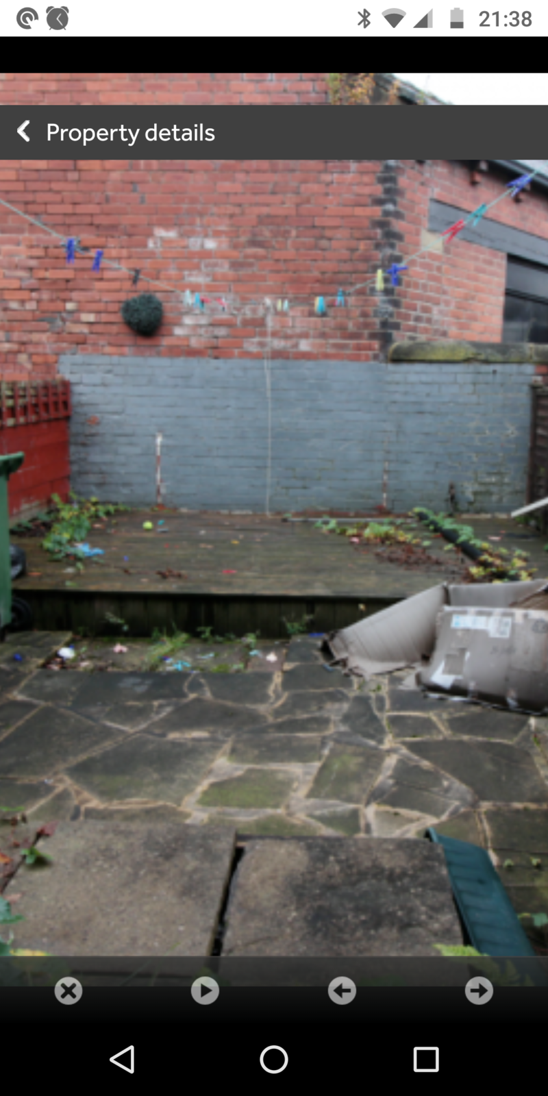

Hi,
I have just bought a small 2 bed terraced house with a garden big enough to put my log cabin in (for work).
Please see attached the photo of how the garden looks now. The raised section at the back is decking but it looks like it has been there a long time!
Access to the back garden is via a small footpath at the sides of the houses, so i am not going to be able to get any tonne bags dropped off to get the base sorted out etc.
What would the best way be to provide a good base for my log cabin to be built on? (i have ordered it from tuin) The log cabin is 3m x 3m
I was going to remove the decking - will soil be under decking or is it likely to be concrete ?
Would you use a timber frame, concrete base etc?

How wide is a small footpath these days?
You don't have to have a poured concrete base for posh sheds. The other popular approach is to have concrete pads at corners and a wooden frame between them.
Decking can hide anything, the only way to know what's there is to take it up.
The footpath is probably about 70--80 cm wide. By concrete pads do you mean breeze blocks? Would i still dig down and then put the block in to make sure that the timber is just above ground level? Do you literally sit the concrete blocks on the ground that is there, or do you have to concrete them in to ground?
