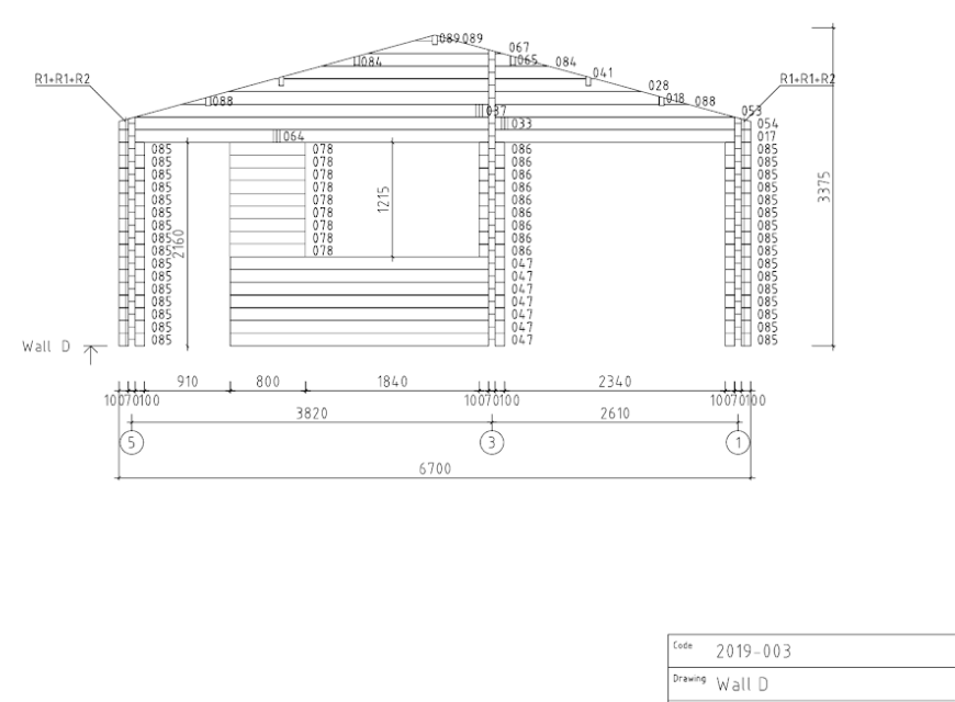

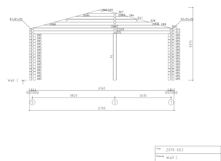

*Updated with elevations, etc*

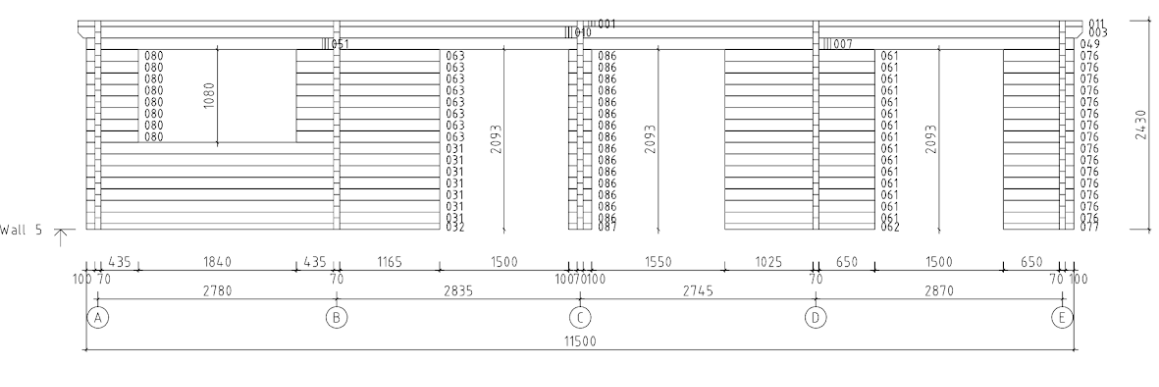

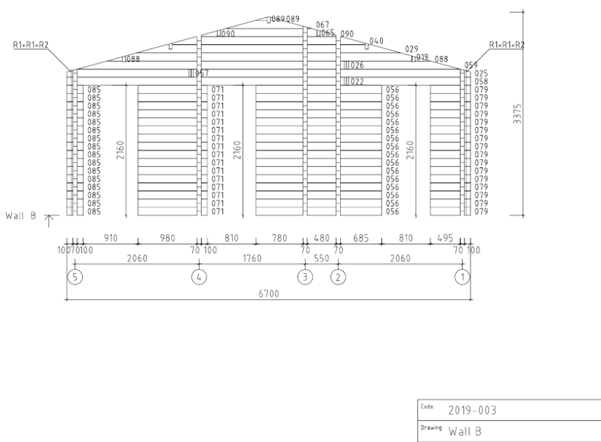

Here are some plans of our log cabin. These are updated versions from the ones we signed off on and we noticed in the very middle they have specified the joist as two pieces, joined under the ridge and braced with an upright which was not there previously. You'll see that rather than using trusses, the roof is designed to be supported on the walls which are built all the way up to the ridge.
You'll see 'notches' in the elevations A-E for these roof beams. I believe they are quite a heavy spec, like 4x2 or even 6x2 presumably to make up for the relatively large joist spacing.
If you look at elevations 3 and C (and to an extent D) you'll see they have 'partitions' at the top, like these were solid walls and they've cut holes in them. We believe this is because our cabin is a bespoke variant on an existing design which did have those walls.
I can see based on this design that the upright is an easy 'fix' but it was not in the design we gave them, or their plans which we signed off on - and it's quite impactful on the overall design.
What I'm wondering is if we can relatively easily avoid the need for this upright - with a long very strong joist basically. If this could be 'dropped in' then great.
Another thing I'm interested in is those 'partitions', especially the one along the cabin (wall 3) - if it is serving a major structural purpose or not.

I think I'll need to post some plans but for now note I said the triangle is filled in, it's not using a typical truss design.
There are effectively 5 'trusses' on an 11.5m length roof and all but this one right in the middle are designed to fit over load bearing walls.
Do to keep the same principle they put a pillar in the plans and didn't mention it. So we're looking to retroactively sort this without changing the main design which is already in construction.

It's a bespoke cabin designed to our plans. But they omitted the post in their official plans sent for approval, and we think only added them in their final version once it went to manufacturing.
Seems most likely it was always supposed to be in their design but we never saw it when we approved the plans.
It's a bit late in the day now, given a 14 week lead time, as we cannot really afford to delay. We're chasing them to address it but I want to look into all options since time is to an extent more valuable than money and if there was a quick fix on our side we might just do that and try to get some reduction on overall cost
Right. Most probably thier cheeky error. If concealed in the ceiling void you could go for the following type joists. but they will need to be fixed to the outer wall. That then adds issues due to the load bearing now shared only be two walls instead of two walls and a support colomun inside.
https://www.merronbrook.co.uk/easi-joist/ Span table on page too.
