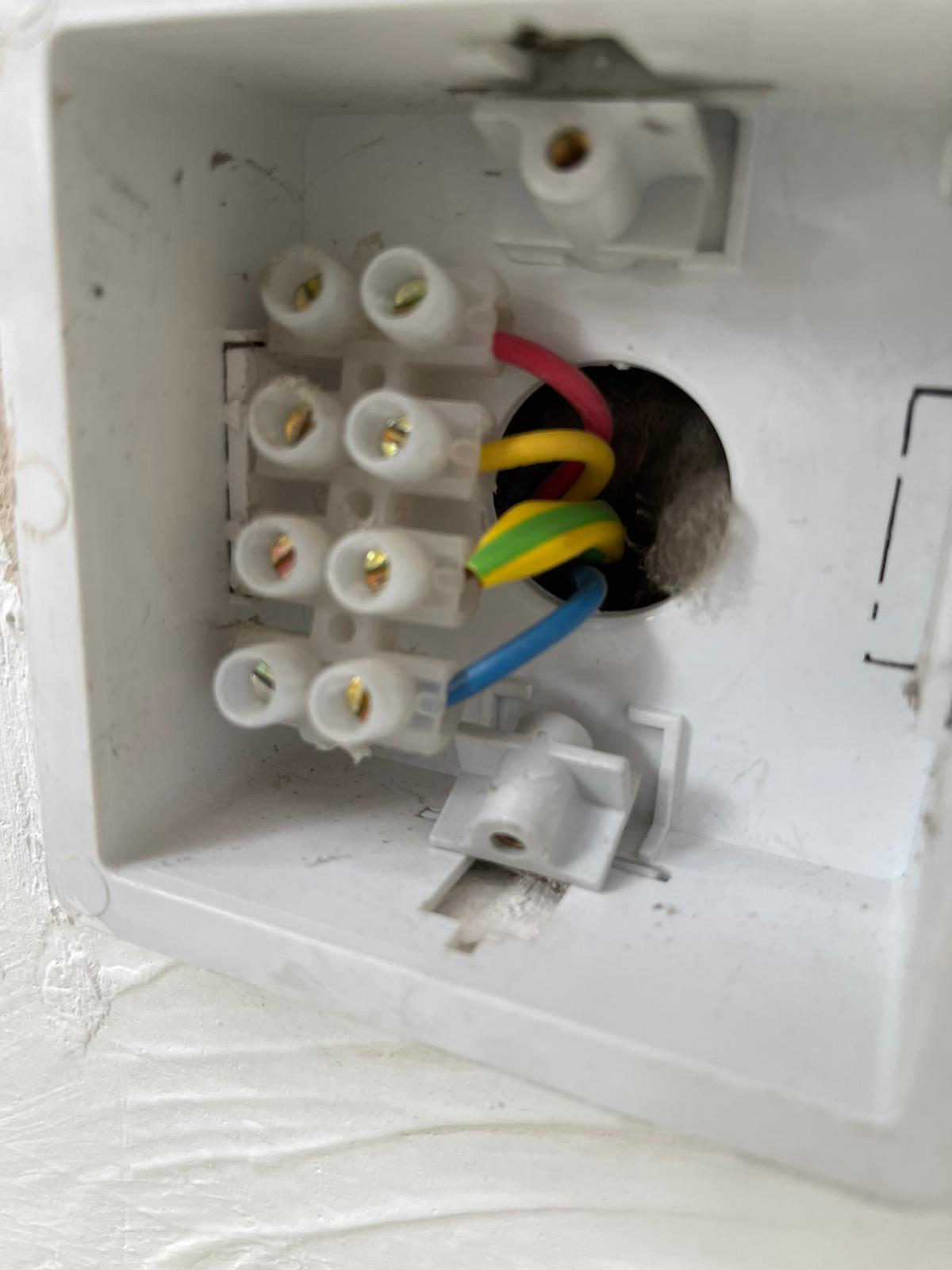

Hi all,
I am trying to find a smoke (or smoke and CO) alarm to go with my current set-up.
I have shown a photo of the connector on the ceiling. As you can see, there are 4 wires there. I assume there is an alarm out there with 4 wires coming out to install here?
When I Google, I only find ones with connecters to simply plug in (they also seem to have only 3 wires).
So do you have any recommendations for me?
Sorry about my ignorance on the subject.
Please help.

What is the current alarm? What location? Aico do a heat and carbon alarm, but mostly suited to kitchens. I think the 4 wires might be interconnecting, Aico support these.
Actually I have 3 of these on the landings of the three floors.
I showed the 3rd floor landing celling on the photo.
Currently they are disconnected and I have battery operated Fire Angels in operation in these places. But I hate those, as they beep for no reason and no amount of vacuuming sorts that out. So my plan is to replace those with the mains units as the wiring is already in place.
Any model number of Aicos I should look for?
Thanks CBW.
That’s 240 v smoke alarm with interlink …..live , neutral, earth and interlink ….I would go with AICO as a brand ….you will have to isolate the mains power before wiring these in
Aico do those I just checked. But these require only 3 wired connections. I assume that the interconnector (yellow) can be made redundant as the alarms will be interconnected wireless.
No one can confirm as it’s up to you to check ….we can assume the yellow is interconnect but best practice is to confirm that red is live and blue neutral with a multimeter
The fourth wire (green/yellow) is an earth wire which wouldn't normally be connected to the smoke detector. So the 3 wire ones will probably be okay.
Aico provide you with an earth (parking) terminal, probably for continuity.
