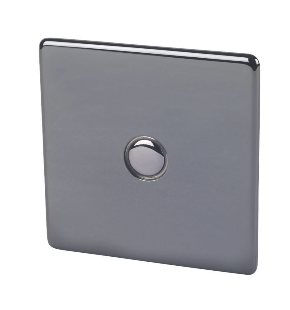

As the title says, I'm looking to find out if a specific type of wall switch/button is available.
I need one that only completes the circuit when the button is pressed, as soon as it is let go the circuit should break again. I have seen dimmer switches that mechanically appear to behave the way I want, but I'm not sure how the operate electrically - i.e. I guess they 'latch' on, and cycle through set resistance levels on order to give the dimming functions. For example - http://www.diy.com/nav/fix/electric...-Touch-Dimmer-Switch-Polished-Chrome-11867867

Yep thats exactly what I'm looking for in terms of function (quite familiar with them in that form!) but I'm looking for one in a house switch panel form similar to the picture in my first post. Are they available?
You can get normal light switches than retract/spring back when you push them. Is that what you want or do you mean you want a button with chrome button/mount exactly as per your picture?
Ideally I would like one with the chrome panel/button as in the picture as it will then tie in with the other counter-level sockets in the kitchen.
Is there a specific term used for the type of switches you mention, that may help me in searching for one in the style I am looking to find?

I don't mind not having a round button, that picture was just the closest thing I had come across, the chrome finish is more important
It will be used to control some decking lights that have a retractive/momentary switch that is used to cycle through the different colours/sequences. But I want to wire them into a proper wall switch instead of having to stick an ugly plastic box somewhere (currently its just a little inline box with a button). I expect I will have to do a bit of soldering to take the wires off to the wall switch but that isnt a problem.

or get a chrome blank plate and chose from one of the hundreds of push to make switches around and create your own bespoke switch
What brand / range are the sockets you're trying to match?
There's likely to be either a retractive switch or a gridswitch module in most major manufacturer's ranges.

No your right, it'll be significantly lower current, although as I will be mounting the switch on the wall I want it to match the current fittings, so therefore will most likely be using a mains specification switch anyway. Thanks for the link, if I end up having to fabricate my own switch panel that could certainly be useful (incidentally if its useful to anyone Polevolt is a great website for automotive wiring - I have built a couple of vehicle/engine harnesses with their components and been very pleased).
Having done some research yesterday this seems like a good option and one I didn't realise I had. Can you recommend any good suppliers of the component parts?
