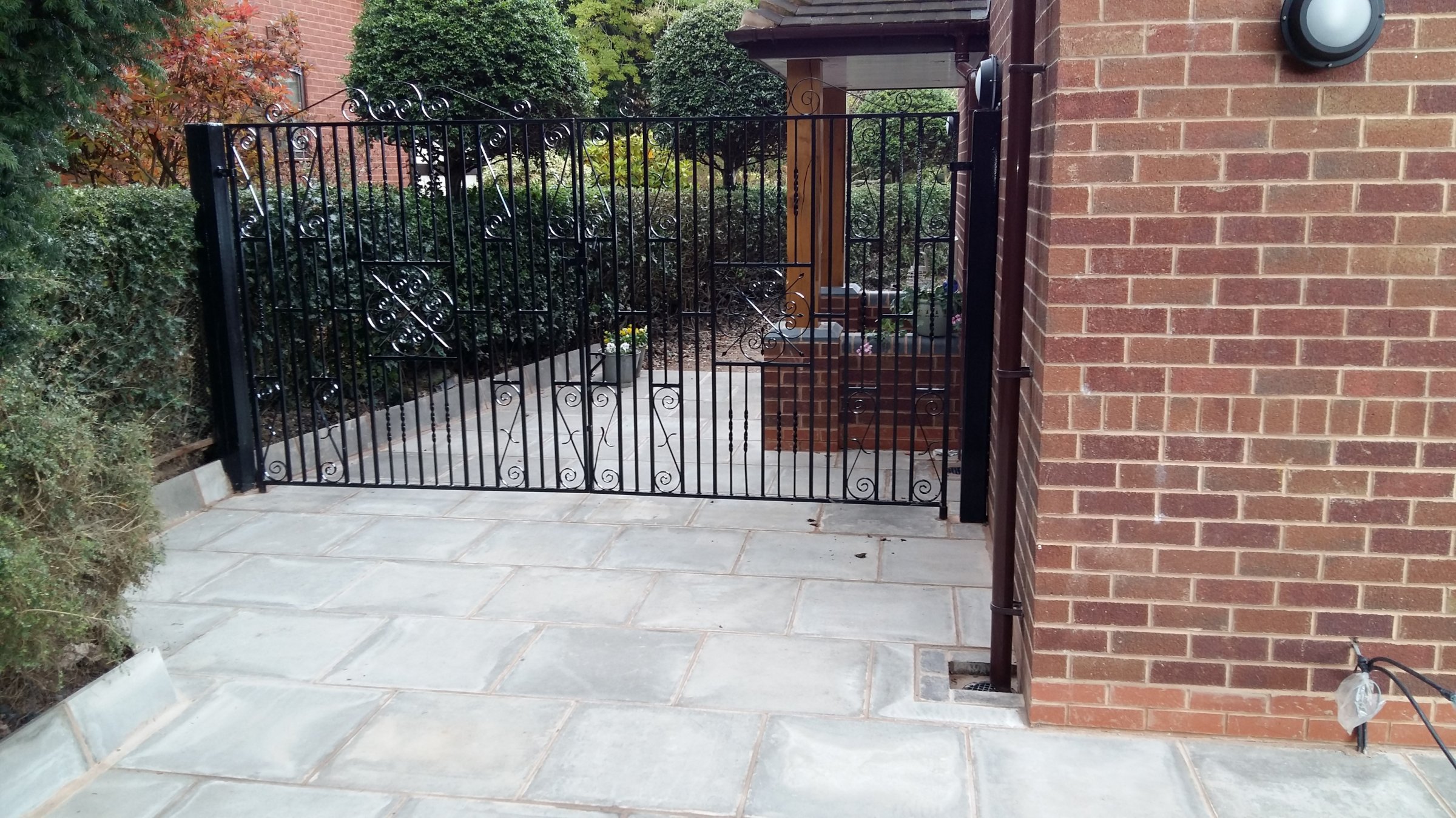

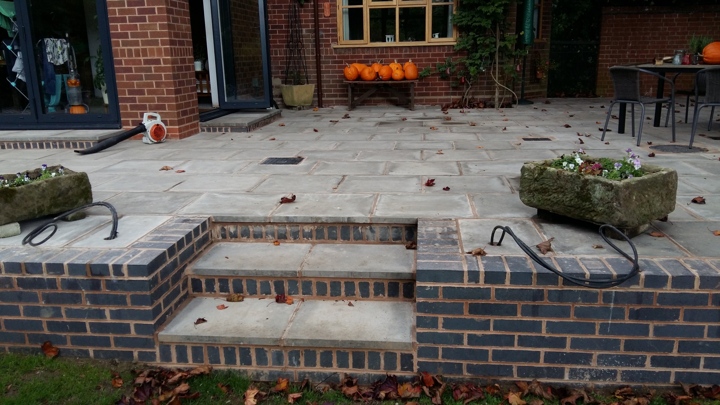

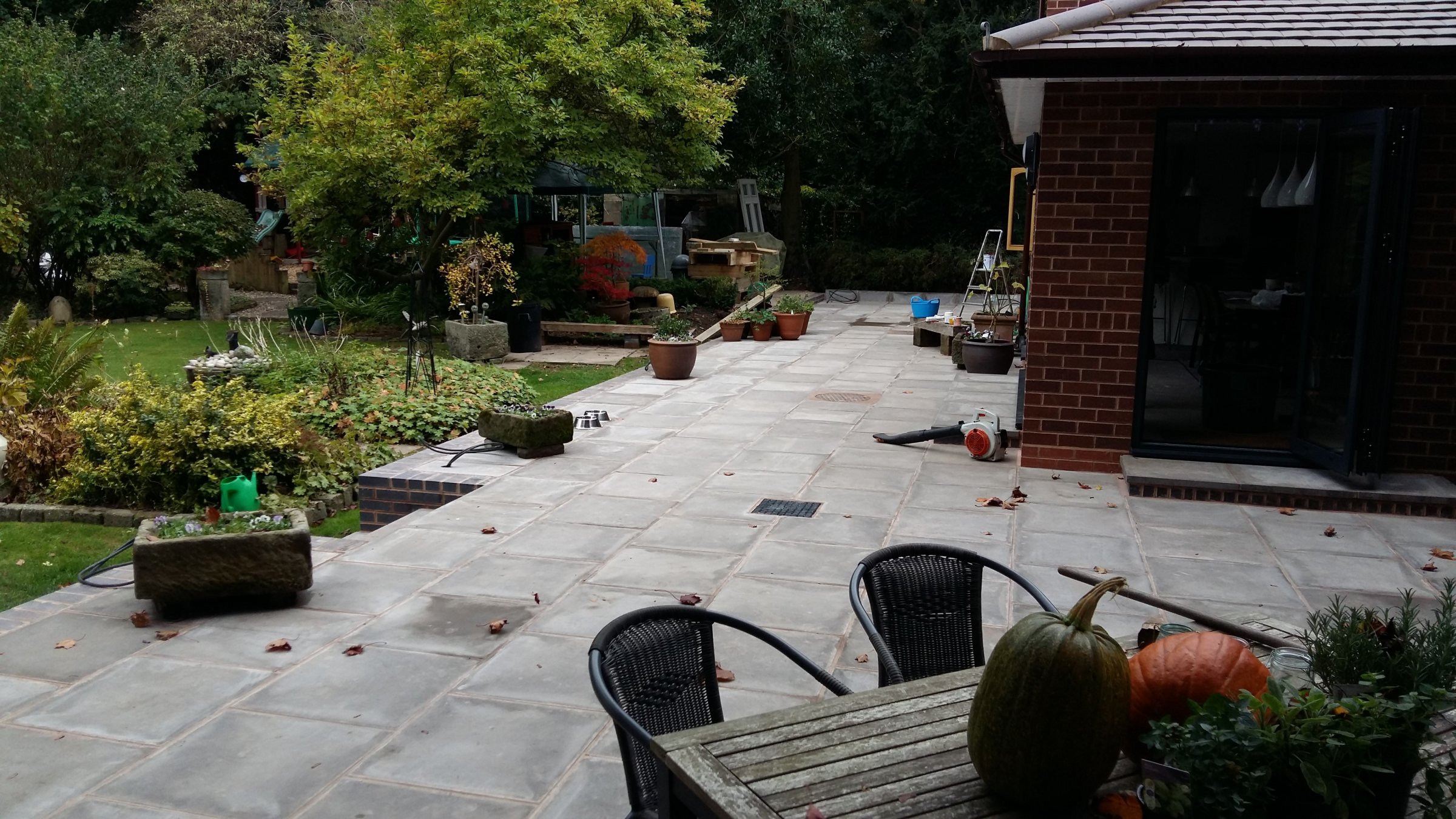

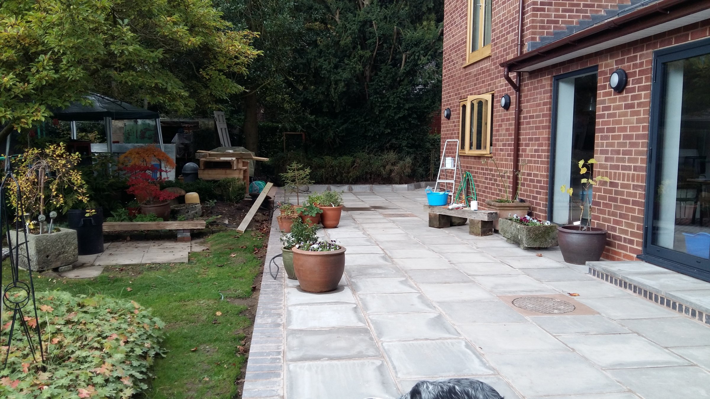

This one was mostly done with a level and straight edges.
I like the idea of finishing the slabs inside the brickwork instead of on top. Used it myself on the last patio and the HO was really pleased with it.
