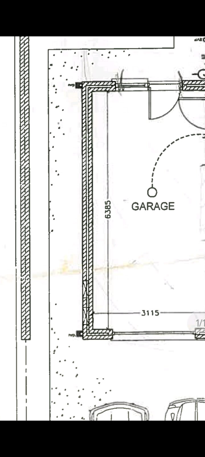

Great replies so far, thanks to all.
Here is a snap of the dwg of the side of the house.
I have a gate at the front and will be adding a gate at the rear at some point.
The party wall is shown on the left.
The neighbours hse is a mirror of mine.
We use the space adjacent to the party wall to store our bins (x3) and coal/wood bunker so the are gets frequent traffic.
Power is available above the garage roof in the loft space.
I like the idea of two 4w lights. I don't want to dazzle the neighbourhood.
I also like dark skies so targeted down lights are preferred.
I like the idea of just lighting the path (great idea) but its a utility area as well so the lighting needs to be above head height.
Not so keen on a 24/7 on approach. I get the costs saving are nil but i am a child of the era of the halogen bulb.
Like PIR.
Like the photocell idea
Like the idea to have a on/off/auto switch but not sure how to do that.

Indeed. There's no need for literal "24/7", but 'dusk to dawn' (with a photocell) is a good compromise.
I've voiced my reservatioins about PIRs in your situation - the main one being that it is unlikley that one could detect you 'soon enough' when you were stepping out of the side door.
If you had to implement it yourself, it's easy enough (ask us if the issue arises) but many/.most PIRs have the facility that if one switch them 'off then on' in rapid succession, they switch into a 'permanently on' mode.
