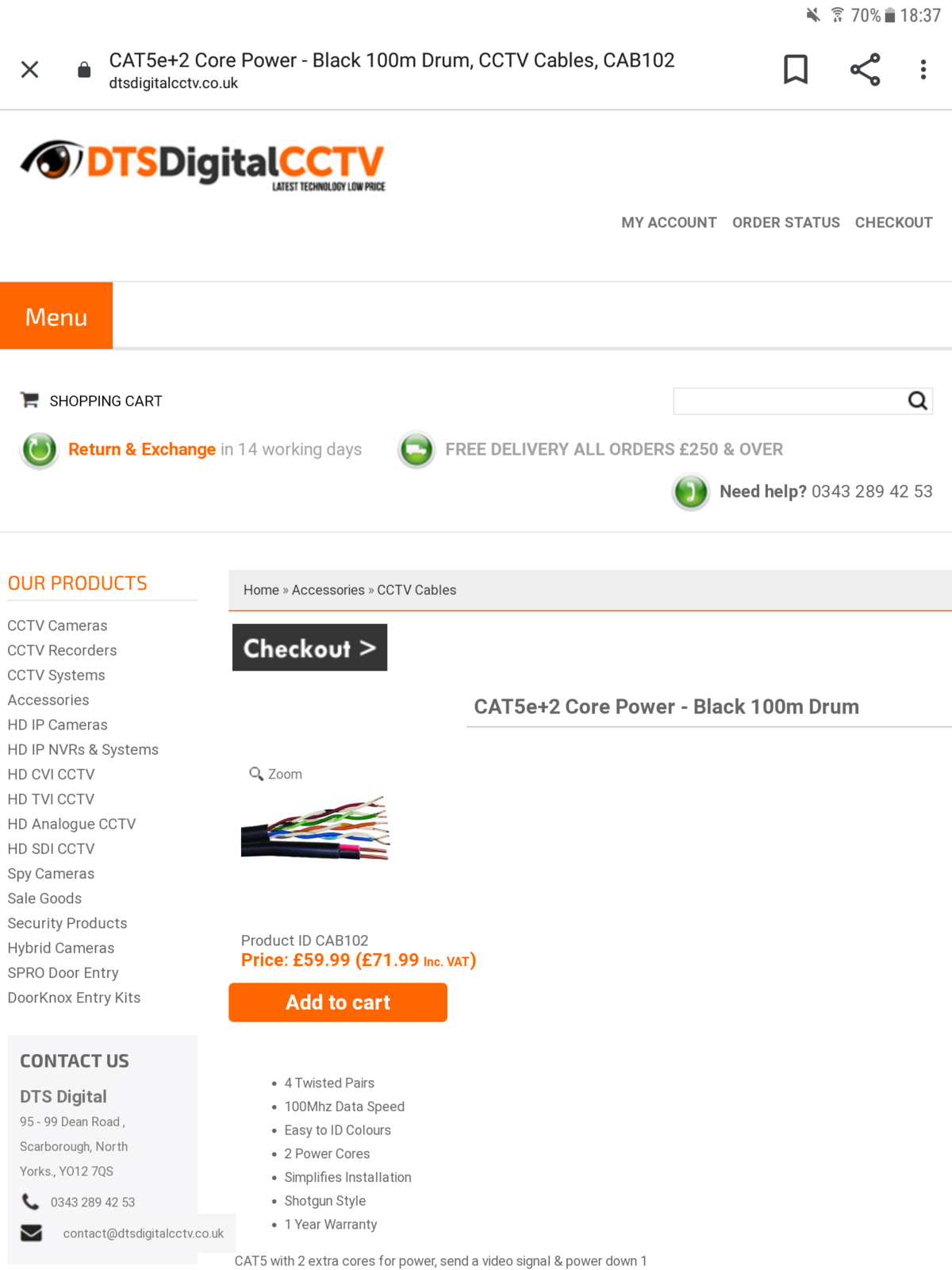

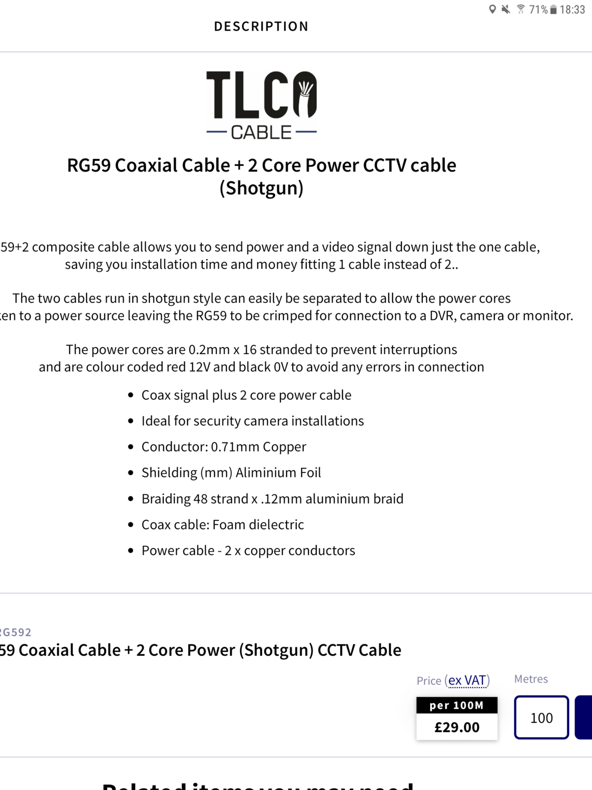

Shot gun cable is sometimes quicker and easier or run individual coax/cat5/6 with separate power cable. Screenshot_20200109-183704.png
You can run a single Cat5e cable and use a power adapter and video balun on a non POE camera.
You can also get POC (Power over Coax) so youn only have 1 cable going to the camera and also no power pupplys as they are powered from the DVR.
