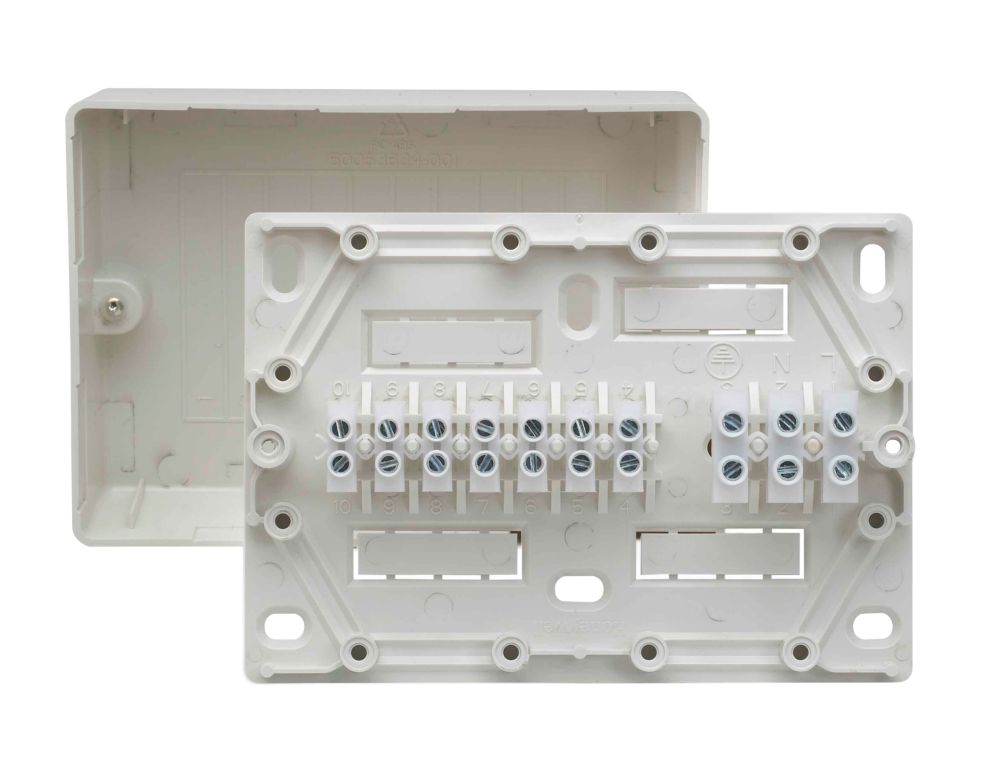

We also see back boxes with strips of block connector used with central heating systems where the installer is too tight to use a proper box.
That is exactly what 'proper boxes' used to be, I removed one this week.
These
are numbered and pre-linked to follow Honeywell plan, and have cable clamps, with the socket back box and blanking plate there were often no clamps and chock block was left floating with each installer developing his own unique plan so maintenance was difficult. OK some boxes were not as good
ae235
but even that one the terminals are fixed and it does have the 10 terminals to match honeywell plan. Ups I see yes problem with first one, that one could not follow Honeywell plan as too many terminals.
These
ae235
Yep, and I think I posted something similar a few months back where the clamps had not been used. But the original wiring centres were nothing more than a back box, strip of choc block and a blanking plate with some sort of name on it, either printed/transfer or stuck on. Eventually some came up with an arrangement to fix the connectors in place.
I replaced a Honeywell one last week for a boiler replacement.
