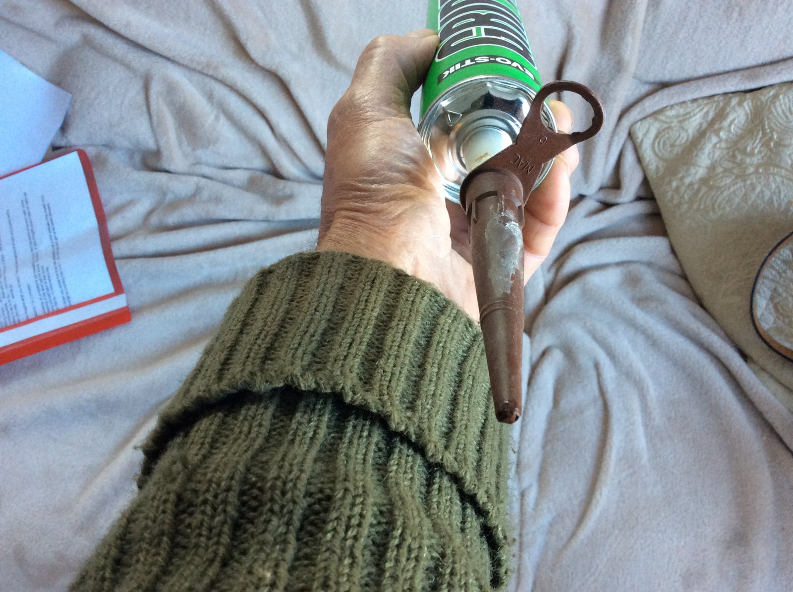

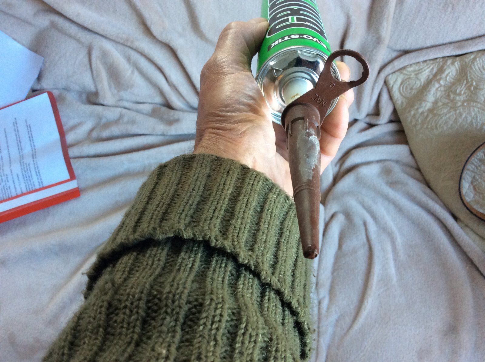

Thanks all this is very helpful. I will use the no more nails approach here. When brought in a tube (used with gun) is there a way to keep this for future use?
In future, I will start with a pilot hole, then slighter bigger hole and then the actual size and try not to use the hammer setting.
seal the end of a caulking cartridge with hot iron or flame and push it on, doesnt last for ever but does help
