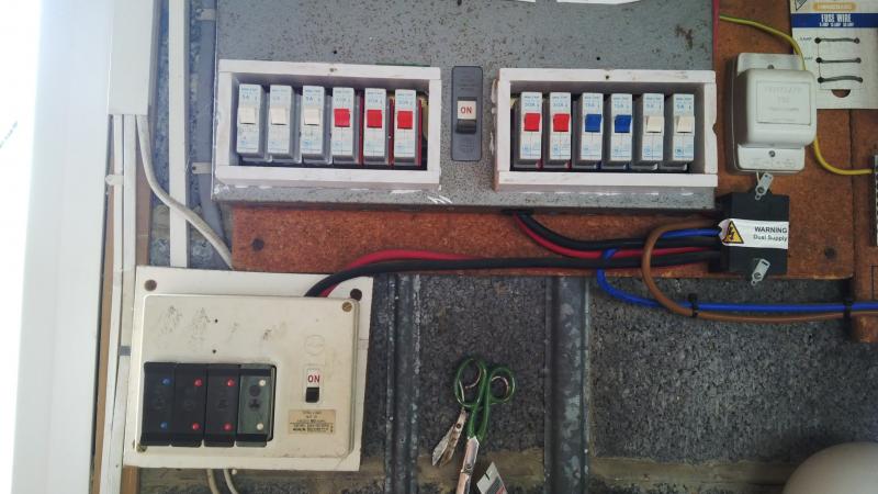

Right, managed to fix that little issue (the original wiring had a crossed wire, God only knows how it worked before!) but we seem to have at least one dead wire in the original SWA, and it currently terminates in the shower room anyway which seems a pretty daft place for it to finish up, so....
Was thinking of getting a spark in to replace the cable and take the opportunity to sort out some of the wiring mess (well, I am going to do the digging of the trench, and pull the cables through - labour intensive thus expensive but non-technical manual bits - and he will come do the 'connect it together, check it out and sign it off' part), then get him to install a CU in the [dry] pump room and take the SWA to there.
However (as I like to know what I am looking at)...
At the moment the mains feed comes from the meter into a Henley where it splits into 3 (main house CU, smaller fusebox used for poolhouse, which is what I am about to have replaced, and third feed up to Solar PV system - see photo earlier). Is it normal to split the mains feed like that? The PV seems to be on 16mm tails, whereas the other two are on... 'chunkier'... cables.
Reason I am asking is I was thinking of getting the sparks to set it up as follows:
Mains feed to split (again?! Can he do 4 feeds off the mains via one block?) into:
a) 2 way CU (63A RCD) in garage (where existing old fuse box is) to swimming pool filter pump (32A) and socket (16A) - it needs to be this end, as it goes to a timer which drives the heating pump in the room next door). From there it will feed into the 2 cores of a 10mm SWA to take the power to the pump room itself, where it connects directly to th pump via an isolator - most of this is existing, it's just the 'connection to mains' that needs to change. I understand that both the CU and the SWA will be earthed to the earth block that is already in place. No idea where it goes from there to earth (checking for PME was mentioned) - that's for the spark to sort out :)
b) Take mains directly down the other 2 of the 4 cores in a new 10mm2 SWA to a new (100A RCD) CU in the pump room itself, where it will then feed the 4 separate circuits already in place: lights (6A), sockets (16A), sauna (40A) and shower (7.5kw on 40A). I think that end is then going to earth out to an earth rod - local TT at the pump room end to earth off both the CU and the SWA - we are only about a metre above the water table here.
Is it ok for him to feed mains directly into 2 cores of the SWA (it will connect to the CU/100A RCD at the other end) or should he be telling me it needs to go through some sort of isolator at the head end? before it goes into the SWA? (He seemed to leave that out, but kept going on about wiring the house, but I would have thought that was sensible? Or is that overkill? - no pun intended!)
Obviously I realise it needs a qualified Part P sparks to do this - no new circuits but it is replacing an existing circuit and, in part, is (re)wiring a shower. In any event, I'd want to know it is safe.
But I also want to understand what is going on and make sure he is not telling me stuff I don't need (as the last one I got in to quote started with "we need to change the incoming RCD, the whole mains CU and rewire the whole house"...)!
He seemed to be talking about daisy chaining the existing Henley into yet another Henley (?) to split the supply where it can feed the small CU and go 2 of the 4 core SWA to feed the other larger CU at the other end - these are two separate circuits, not one a sub off the other. Couldn't he just take a 4th feed directly off the existing Henley?
He was also talking about bonding the earth to the water mains (the comment was associated with 'oh, that can be expensive, needs a thick cable mate, it's not pretty') and exporting it to the poolhouse - Wouldn't the TT system in the poolhouse be sufficient for those circuits (subject to testing, of course!)
I have not seen one RCD in the picture and it is clearly very old. The
I am assuming one of those wires (bottom or right) goes to a switch?
1974. Currently no RCDs anywhere. The intention is to introduce two RCD protected circuits for this outbuilding only, at this stage.
Yes, that's just part of the existing lighting circuit within the outbuilding. I just took the cover off to check the wiring. 'In, out, lamp switch'
I would guess since wired there have been many changes including how the water and gas get to the property and it is likely it also has some old ELCB-v fitted so one has to be careful bonding as it could make things worse not better.
No gas anywhere in the village. No changes to incoming water feed since 1974. House was my fathers from new build.

Ok, this should be the rough layout of what I am proposing the electrician does. Compare that with the photo of the board below:
You can see the old fusebox that will be removed, the existing Henley with 3 (currently) tails out going to main home CU, fusebox and (new 16mm) tails to Solar PV system.
What you can't see on this photo is an old switch at th top which isolates teh whole system from the incoming mains. It's not a modern RCD/switch isolator, just an up/down switch.
I suppose the question is whether (in effect) 2 cores of the 10mm2 SWA can be connected directly to the Henley or it must go through another switch/isolator (which the electrician seems to have left out)??

Unless I'm misunderstanding the nature of the box labelled "63A RCD for filter pump only" (see below), there is no over-current protection on whatever is going into the boiler room other than the supplier's service fuse.
What does that do then? If it feeds to a 100A RCD in the CU at the other end, or does it just protect the other end of the cable?
An RCD, per se, offers no protection against over-current (only against leakages to earth) and, in any event, it is downstream of the SWA. If the connection between the supply and a CU is more than 2-3 metres in length, a fuse (other than the supplier's service fuse) upstream of that connection is required.
Ah, yes, I see that now. So a switchfuse would be expected to go between the mains feed and the 63A RCD (the small CU in the garage) as over-current protection?
This is a self contained circuit which runs:
Mains > 2 way CU (63A RCD, 16A and 32A MCB) > loop on 32A MCB to boiler house for timer > 25m of SWA to poolhouse > switch > filter pump.

Ah, my drawing. The label that reads '63A RCD for filter pump only' relates to the small 2 way CU in the garage, not anything in the boiler room. There is no RCD in the boiler house; just a loop on the pump circuit that goes to a timer and back to the CU (32A MCB) in the garage

The way I was drawing it, the 4 core SWA is attached to the small CU in the garage. 2 of the cores take the outlet from this CU to the filter pump. This circuit only runs the filter pump because it has to go to the timer.
The other 2 cores just take power directly to the other CU in the pumproom.
So, 2 cores go through the mini CU (and MCB within that) in the garage. The other 2 cores directly go to the pumproom where they go through the other CU (and MCBs within that) which feeds the lights, sauna, sockets...
Two different circuits, making use of the 4 cores in the SWA as two pairs.
The only reason for splitting them was because the pump circuit needs to attach to the timer.

OK, I think I may now understand. The two cores going to the pumproom are simply 'passing through' that mini-CU, from the supply to the CU in the pumproom - is that correct? If so (a) those cores would need switch-fuse protection and (b) given the size of SWA you are thinking aout, there's no way that you are going to be able to do that wiring within a standard 'mini-CU, if that's what we are talking about - at the least, you would need a decent sized one. However, in view of the need for a swith-fuse, an alternative arrangement would probably be used - e.g. terminating the SWA in another box and taking feeds to that from (a) the mini-CU and (b) from the Henleys, via switch-fuse (for the supply to the poolroom CU).
Given that it's a mini-CU with MCBs, if it's close enough to the supply (which it probably will be), you wouldn't need the switch-fuse I've been talking about...
I'm curious now why proximity to the supply would mean it wasn't necessary...?
If, as in the normal domestic installation, the distance from the supply (meter) is less than 2-3 metres, then additional protection of that cabling is not deemed necessary. However, if the distance from supply to CU is longer than that, fuse protection is considered necessary.
