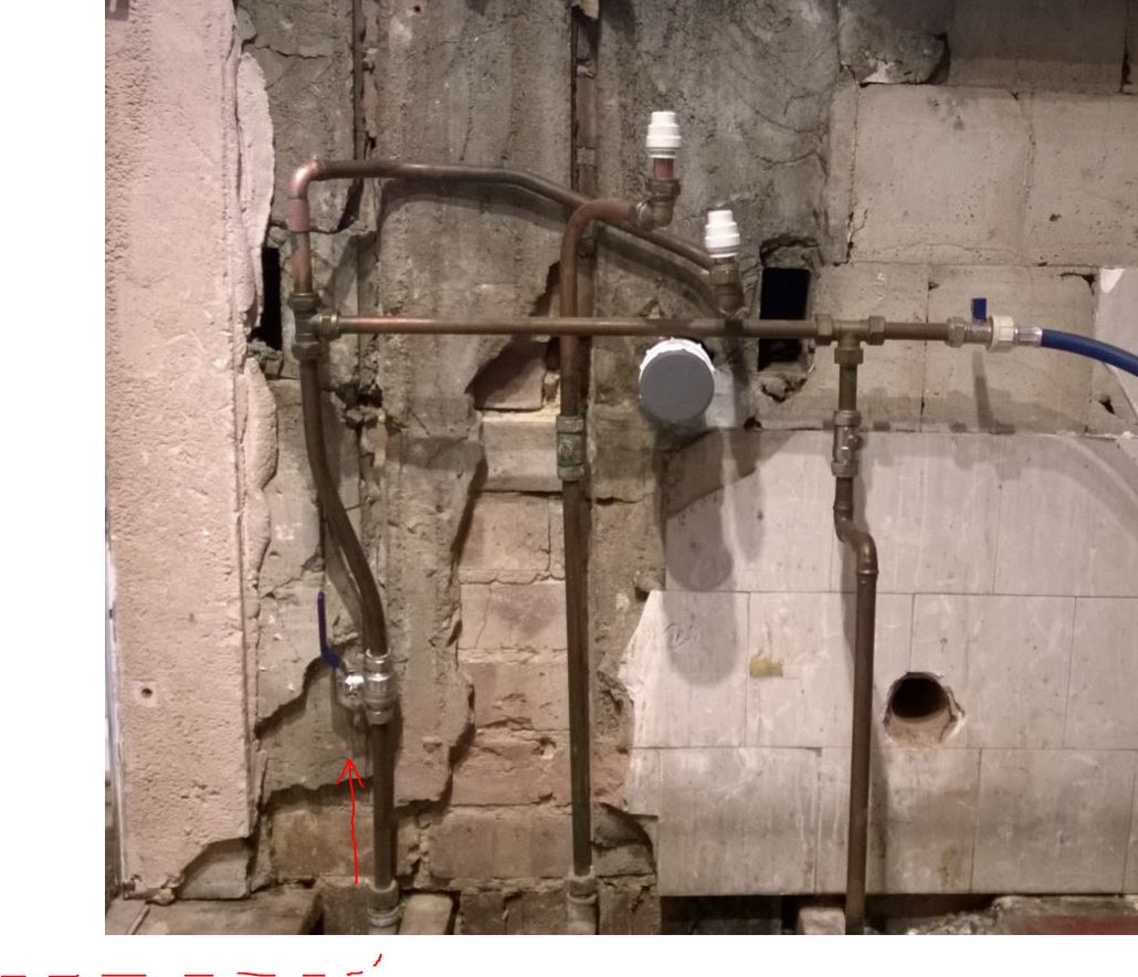

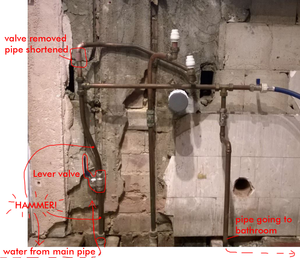

Unfortunately it made no difference :( I had to really lower my lever valve to almost off to dampen down the sound and have very low water pressure as a result now. It almost sounds like the high water pressure is hitting the valve when I touch the pipe below the lever valve I can really feel the "ssshunk!" sound vibrate, touching the pipes beyong the lever valve and it's not as strong. Is it possible it has something to do with my lever valve and the high water pressure going through it? here is a picture of the pipes in my kitchen. The large iron mains supply pipe is to the left on the wall and it runs under the floor, connecting to the copper with the newly installed lever valve.
All you can do really is try a new valve and see if it sorts it. Could be a sympathetic vibration off of the ball valve, though holding the lever usually stops/changes that, so it's then obvious it's a faulty valve. If it sorts it though take the other one back.
Yeah it could be that, though the valve was brand new and the banging noises were not present when it was installed, they have come on only recently. I did notice at the time I noticed them my water pressure was all over the place. When I turned the tap on in the bathroom relatively low the pressure would be shooting out. The tap was very sensitive and I couldn't get low pressure out of it at one point. Also everything like the bath, sink, toilet all make hammer noises when turned off. Wondering if I need to install a device to relieve the hammer pressure?
I wouldn't say that introducing a full bore stop valve would cause the symptoms you're are describing. If it's all started ever since you cut the wall away from the pipe then it has to be someting to do with that, unless that is just coincidental. That as well as your pic shows that none of the pipework is supported.

One solution could be a Washing Machine valve (WMV) with a built in check valve or fit a shock arrestor that sits in between the WMV and the pipe. You could also try an arrestor before your cold mains to try and remove any other outlet that may be causing it.
Cheers Madrab. The washing machine is the flat below so would need to think of installing something at my end. Someone also suggested that it could be air trapped in the faucet pipe that is closed off coming direct from the mains and that there could be air trapped in there that cant escape. Otherwise the shock arrestor sounds like the best option. Where would be the best place to fit it? Before or after the lever valve in the picture?
After would be the easiest but it may be a trial and error.
Air trapped at the end of a pipe would actually act as a shock arrestor, as that's basically what an arrestor is, trapped air and some have an added piston. You can make your own with a piece of pipe and a soldered cap end.
Agreed with madrab that it's a shock wave caused by the moving column of water being stopped abruptly. Ideally the arrestor would be fitted as close as possible to the appliance so it is"in front" of the whole column of water and can protect all the pipework, but if it's only bothering you you only need to protect your own. Fit it as early as you can in your pipe work, as long as it's before any tees or bends it should absorb any pressure waves before they bang your pipes.
