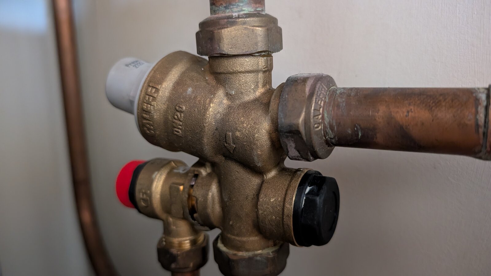

Quite possibly the (normally) 3bar pressure reducing valve (PRV) on the cold water supply to the UV cylinder, could be a blocked strainer in this or a faulty PRV, there may be a tapping on the PRV to attach a pressure gauge.
Thanks for the reply :-) would this be the one?

@Johntheo Why would the Pressure reducing on Unvented hot water cylinder affect the cold water to anything other than the balanced shower outlet --- balanced tapping has been unused in both homes I have had unvented in (from original new build install)? (It's the blank black cap on that photo above).

Thanks for the reply :) would this be the one? View attachment 390550View attachment 390551
Yes, thats the one, the pipe going off to the right is the balanced cold, (after the PRV), the black plastic plug underneath it is where the expansion vessel is often teed off from. If the kitchen cold tap is supplied from this balanced cold and has a reduced flow from normal but the hot water supply is normal then yes, very unlikely to be the PRV (pressure reducing valve) although 8LPM from a kitchen tap is IMO pretty good.
Also, of course there is a relationship between flow and pressure but its not directly proportional, flow is proportional to the sq.root of pressure, if you assume that the pressure after the PRV is normally 3.0bar but for whatever reason has now fallen to 1.5bar, if it is restored to 3.0 bar then the flow through that cold tap, if supplied from the balanced cold, will not increase to 16LPM but will increase to 8*sqroot(3/1.5), 11.3LPM.

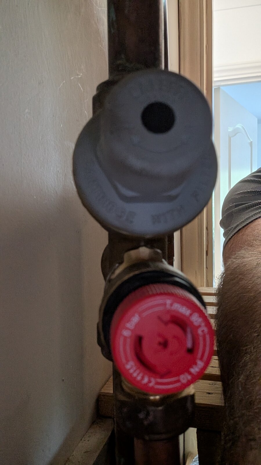

At the top of the grey PRV there is a small round back cap, I was expecting to see a calibration screw that could he adjusted? Does the black cap come off or is there a different way to adjust the pressure on this one?
Not usually - the control group's (combination/multibloc valve's) PRV for the UV will be factory set to the UV's max inlet pressure, that should not be adjustable.

I would get a isolating valve and pressure gauge installed where that black plug is and leave it permanently installed, as a first step.
If the HW pressure and flow is fine then it's nothing to do with the unvented. As the unvented is controlled by the combination valve (CV) and if that was at fault then the HW would also be effected.
I would probably be looking more towards the kitchen tap and the pipework @ that location rather than anything to do with the BS. Though the BS could easily be tested though by isolating the CV, disconnect the BS pipe and then connect a test piece of 22mm with an elbow @ the end and check the flow into a bucket @ that point.
