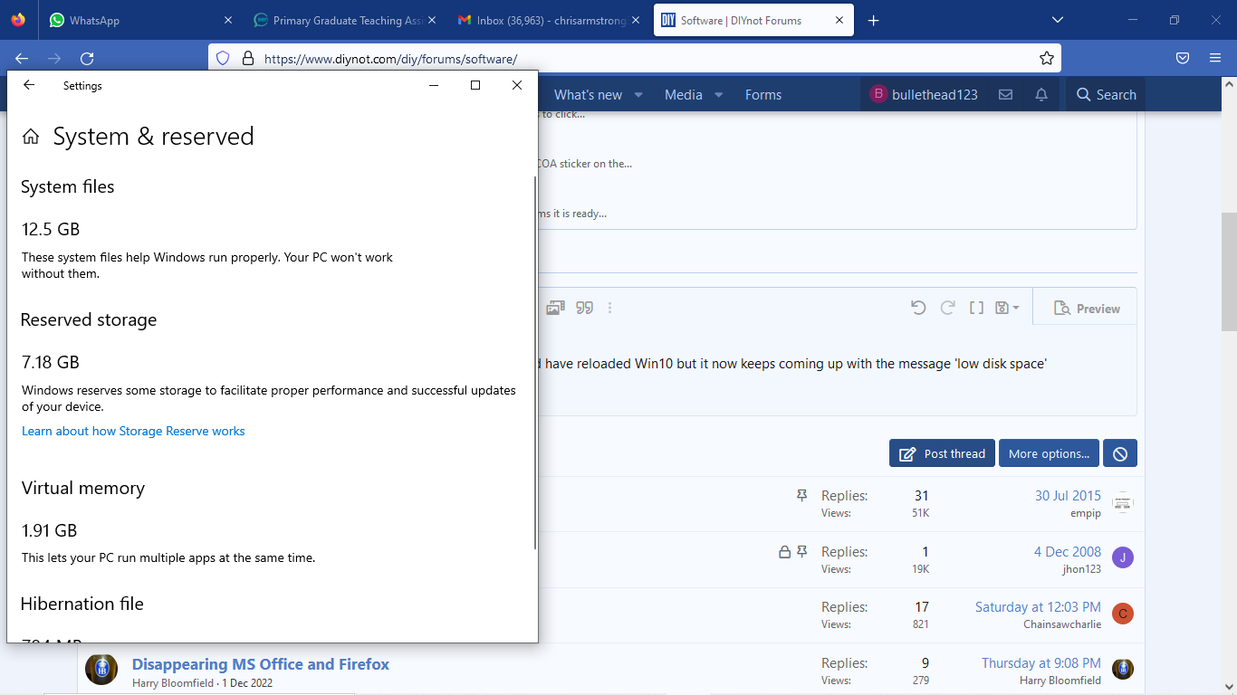

Hi all,
I've inherited a nice little laptop (Acer Spin1 SP111-31 series) and have reloaded Win10 but it now keeps coming up with the message 'low disk space'. Settings tells me that 12.5GB is used up with system files. Is this normal or have I got the old software (from the previous user) clogging up the works?
If not, Is ther anyway I can increase the size of the memory in order to get the damn thing to function correctly?
Thanks, Chris.

Windows keeps back-ups of the previous system files whenever it does an upgrade, in case it needs to roll back. If you've had the new version for about a week without issues, it's safe to clear the system files.
Plenty on youtube on upgrading the hard drive and the RAM. Upgrade the HDD with an SSD if it has a mechanical HDD.

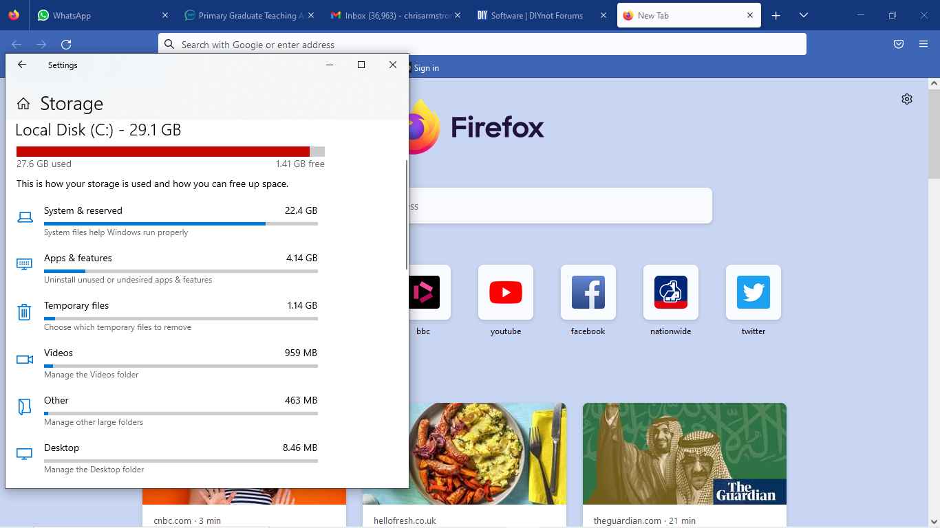

Totally normal.
The reality is that 32GB is not enough for any modern version of Windows.
It will run, but installing anything else will fill up whatever space is left, and when Windows decides to update, it will get stuck in a permanent loop of
not enough space to download updates - you delete things - updates are partly downloaded - not enough space to continue - please delete more
until the version you are using becomes too old, and then it's continuous warnings about everything being out of date.
Upgrading the internal storage is very likely a dead end as well, as it's likely to be eMMC soldered onto the motherboard.
If it's got an SD card slot for extra storage, that's very likely a bust as well, as most of those only show up after Windows has loaded, so you can download updates to it, but when it reboots to install those updates, the SD card isn't mounted and therefore doesn't exist as far as the update process is concerned.

Since you re-installed, just check in your C: drive that there isn't a Windows.old folder which would be the previous install. This can then be deleted.
To check if the disk has been partioned, press the Windows key and R to display the Run box.
Type: diskmgmt.msc and press Enter.
This will show you all drives and their partitions.

This laptop only has an eMMC (an embedded MultiMedia Card) - a memory card soldered directly to the PCB. It's not (easily) upgradeable.
