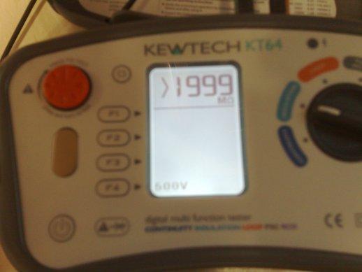

I kid you not was so surprised after my dear old Robin. Just changed my Robin for Kewtech KT 64. It measures greater than 199 at 250v, but at 500v and 1000v it measures greater than 1999. What I really like is the the L probe with integral test button........no more trying to imitate an octupus!!!!!!!!
Other way round for me!!
Always used to getting >1999 M ohms with a Robin then when I got my Megger 1502/2 highest reading is >299M ohm.
L Probe very cool!!!!

Well it complies...........but I for one would be a little upset to get a reading of 11Mohms ON A BRAND NEW CIRCUIT. As far as I am concerned if I don't get greater than 1999MOhms I wouldn't be happy.
I was going to say the same - whenever I've tested a new circuit I've always seen ">1.999G" on the display.
Maybe the forthcoming calibration will shatter my illusions...
