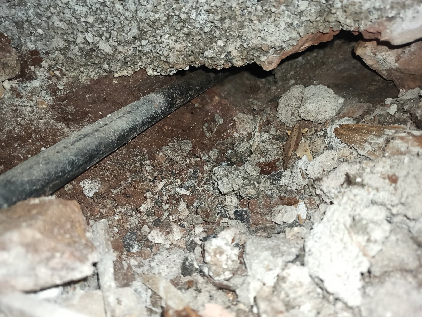

Had the water board round and they have 3 bar of static pressure at the meter (same as what i've got internally) and over 25L flow rate. They also measured my garden tap at around 7LPM which is the same figure I came to.
Also lifted some floorboards to find the black poly pipe does exit the property as I was half expecting to find galvanised steel coming into the house and then poly connected up to that.
As it exits the house, I thought it seems unlikely that it isn't black poly all the way to the meter?

The water board said poly is coming to the end of its life and lots are leaking now so seems like it's best to not b*gger around with it and go with option 2?

Had a new main moled in. They said there was a section of galvanised and copper just before the water meter. As you'd expect, issues all sorted now, can flush the toilet whilst having a shower and not even notice.
