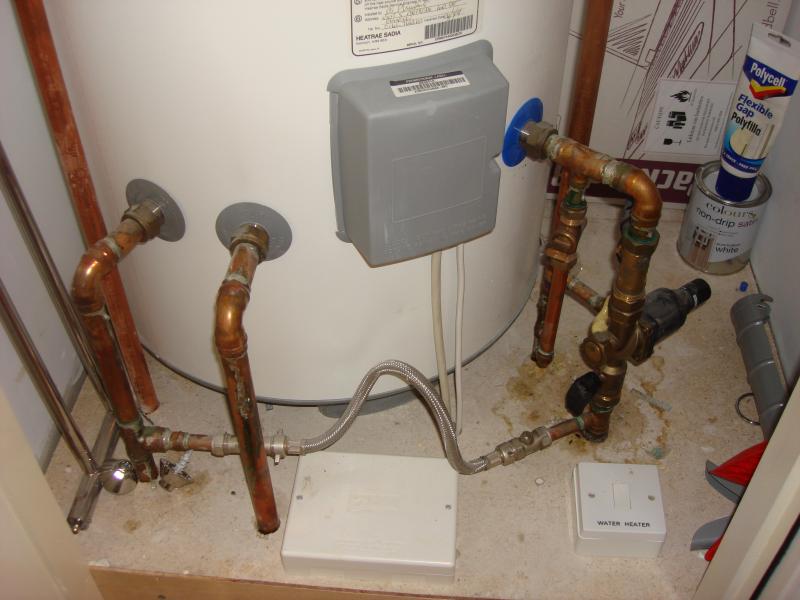

Hi all!
Looking for some help here, i currently have very low pressure in my boiler (Ideal Icos HE15 Condensing Heating Boiler). Can anyone advise me how i can raise the pressure? the gauge currently shows about 0.2 BAR resulting in some of my radiators being cold. Thanks!
there should be one of these somewhere on your pipework, usually its just under the boiler or near the hot water cylinder.
Turn it on, wait for the pressure to increase, then turn it off again. The pressure may be low due to a boiler fault, if it drops again we can advise
The valves are at either end of the silver pipe, you may need a screwdriver to operate them.
Looke like youv'e had a leak round that cold pipe? or was it there before?.
Ah yeah don't mention that cold pipe!! Came home from a holiday last christmas to find the place flooded! Anyway i turned the grub screw at the end of the flexi pipe a quarter turn and then back and everythings sorted, my pressures now between 1 and 2 bar so thanks very much for all your help!
mind if you bleed your radiators you'll need to repressurise again !
