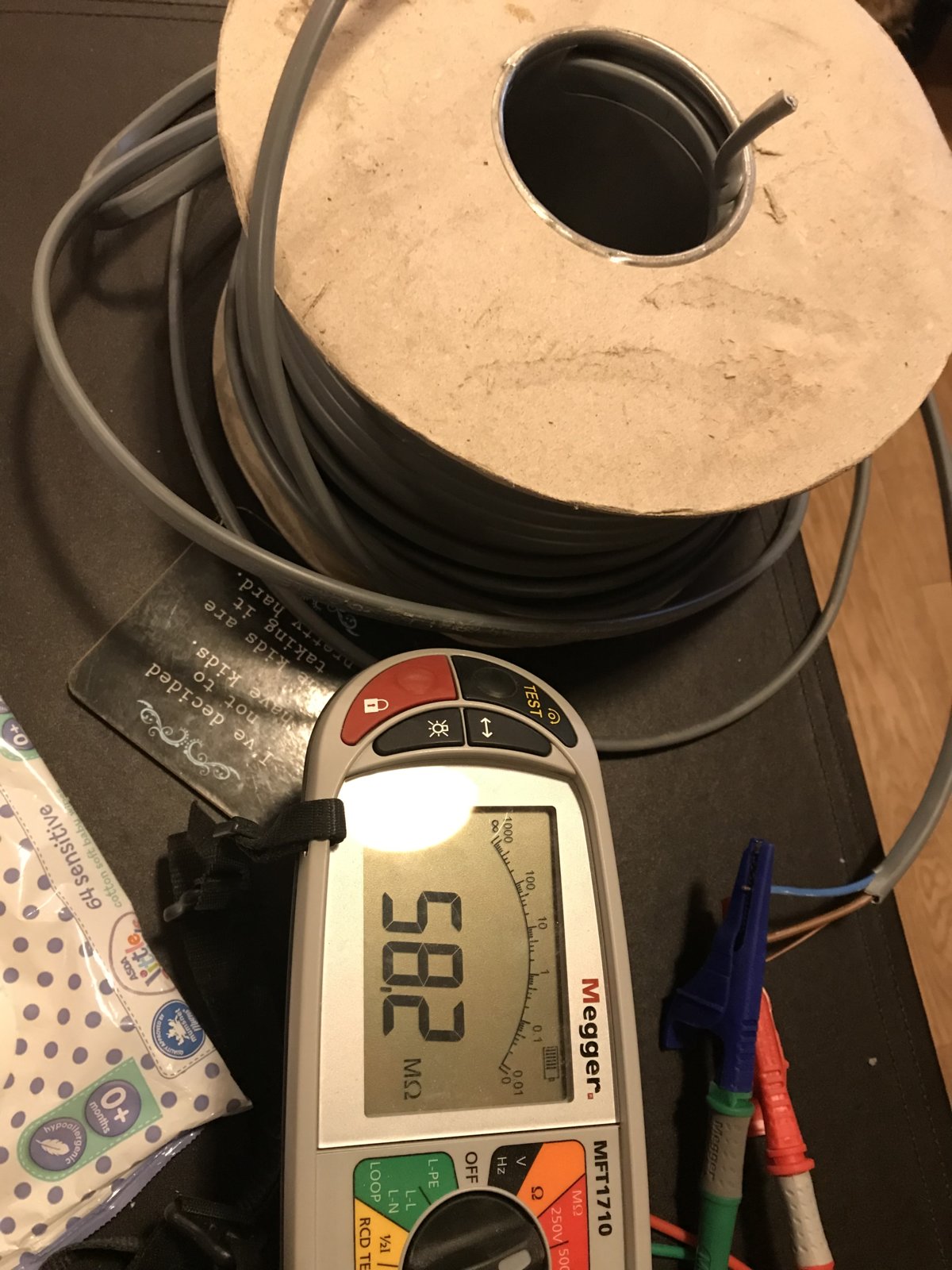

Yep I still have have a whole reel and half left over, so I will be running a test on that tonight. I used about 5 reels of the 2.5 in the house, all stored the same way in the garage and then installed 6 months ago, but never got round to testing. Just left at 1st fix for 6 months over winter etc.

Well just grabbed a reel and done a test on it. Guess what 58.2M. If I hold the test button down the longer I do the higher it goes.
Can't argue with that!
What reading do you get with the meter's probes connected to nothing (and well apart, and away from you!)?
