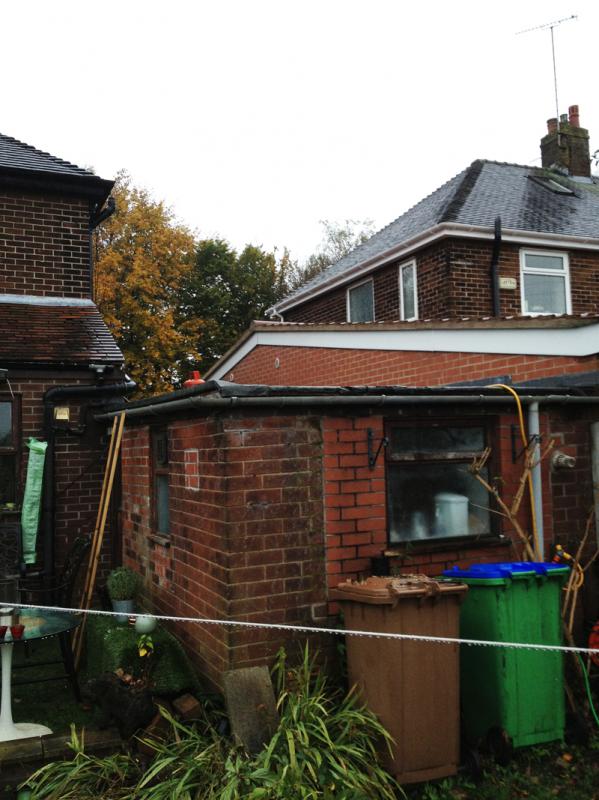

I.m having work done to the side of my 1950s house, basckly putting a roof over the garage kitchrn and utility room, (long extension ) low pitch, connected to next doors roof. I,m looking for tiles to match in with my existing roof which are Rosemary brindle looking. thanks inadvance j.
Rosemary (plains) are not suitable for shallow pitch roofs.
In fact their recommended minimum pitch is 35 degrees.

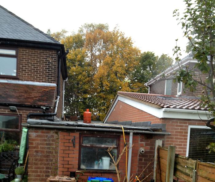

Hi again I have put two photos on the site hope this helps I’m not looking for Rosemary’s / Hawkins as such but something as a lookalike or a cheaper alternative. I really don’t want these double Romans eitherthanks in advance J.
That's as flat as a pancake, any tile on that roof is destined to leak. it needs a flat roof material not tile.
Santoff 20/20 will go down to 15 degrees.
.......provided the roof is as simple as the come with no awkward obstacles.
People need to read the small print regards tiling low pitched roofs, in that the manufacturers only guarantee their tiles provided the roof is a simplistic design.
Hello again ,as you look at the picture the left is myself the right is my neighbours both roofs will be attached obviously with a drain in the middle, it will run from the garage past the side and a 10ft utility room on the end so it’s quite long. Thanks in advance J.
