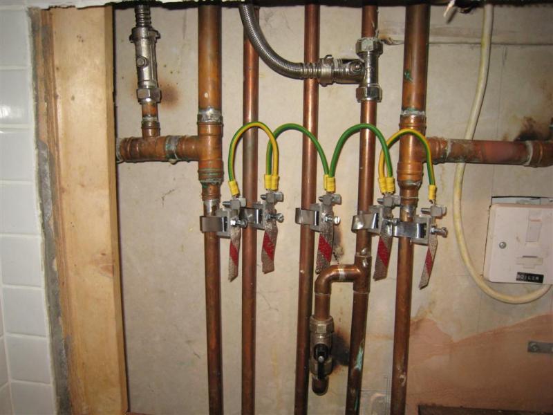

I have the exact same boiler (Vaillian ecoTEC pro 28 ) that has lost water pressure (it is sitting at 0.2 bars) and is showing error F22. I was hoping to be able to re-pressurise the system using the filling loop, but when I opened up the board I discovered that there were no obvious taps on the filling loop (see picture below). I have both loosened and tightened the screw on the right silver connector without any luck.
As you can see from the picture the tap the flow loop has always been opened (I didn't turn it) so it should surely just be a matter of 'opening' the flow loop. I'm really quite stuck here and I'd appreciate any assistance you can provide. Thanks!
EDIT: I just sorted it out. With my filling loop the screw is attached to a top that one can turn with a pair of pliers. So finally we have hot water again!
That looks like a DIY boiler installation.
The filling loop has been connected to the flow pipe instead of the return.

Exactly as it is with the built in Vaillant filling loop on The Ecotec 800 range :rolleyes:

its december time and same problem for me....solved in two minutes by turning the two white knobs and bringing up the pressure. SPECIAL THANKS TO MACHOMANASH.
