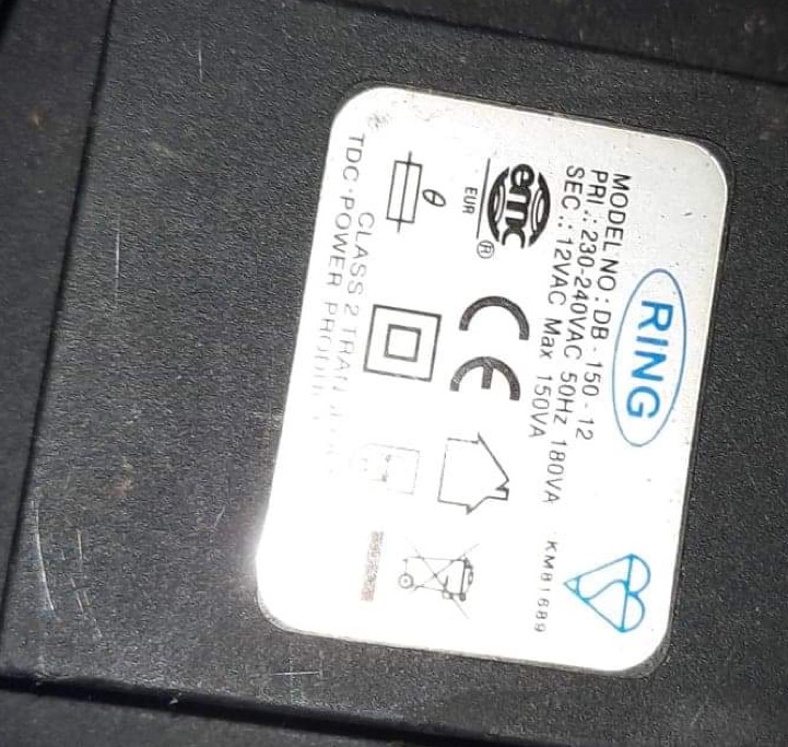

Hi, I have a light setup in my garden which I have had for a number of years, the company who originally sold them was called Selecta light, it’s a modular system, you have a Power supply big enough to cover the amount of lights you have (I currently have 4) then you buy the amount of cable you need and then the lights connect to the main cable with a screw in type connector that pierces the cable. I also have a dusk till dawn sensor so the lights activate automatically.
The system is brilliant and has been a good buy but I want to extend and they no longer have a web site, can I just connect any 12V lights to the system and they will work?
I have included a picture of my power supply, the cable has SCT-2 written on it.

No reason extra 12 volt lights can’t be added as long as the total does not exceed the rating of the power supply which is shown as 150VA.

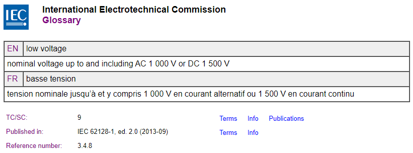

If you really want to confuse the OP, you might add that, in the eyes of the IEC electrotechnical dictionary 12 volts is also Low Voltage, as well as being Extra Low Voltage.
We know that he's talking about 12 volts, and that's all that matters.
No, just enlighten him/her. We know it is 12 volts as that was stated. Correct terms are important for safety.

To actually give an answer to your question:-
The output of the Power Supply is 12 V AC, so any lights connected, up to the maximum of 150 VA (Roughly speaking, 150 W),
must work on AC
If you use LEDs (which would be a good idea) the DC LED lamps must include a Bridge Rectifier. - in order to work on the AC supply.

If you regarded this is 'incorrect', then I would have to wonder what it is that qualifies you to question a definition produced by such an international organisation. The IEC clearly regard "ELV" as being a subset of LV, not a mutually-exclusive range.

As Frodo One said, you need 12V ac lights.
And you you need to add up the Wattage of each light that you connect and ensure the total is less than say 150Watts if they are incadencent (old style) lights, or less than 75W if LED lights.

... other than that (in addition to energy consumption issues) the OP's 150 VA power supply would not be adequate for very many halogens!
Kind Regards, John
This was something I looked at years ago before I bought the LED lights recently. I currently have 4-off 5W LED spike lights with a 50W LED driver with the intention of adding another 4 lights to the setup giving a total of about 40W. The same using halogen would need some hefty transformers!
