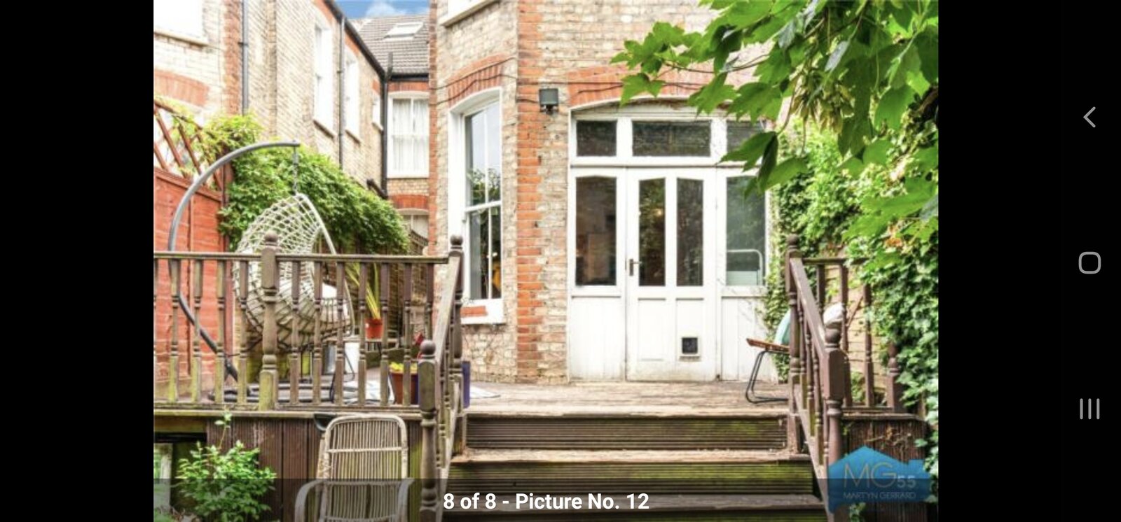

We are planning on extending our current tiny flat in London. We currently have a small living kitchen room that we are planning on extending.
The ceiling height is good at 2.8 metres and we are on a slope. So a potential plan would be to lower the space so we don't lose garden space with steps.
At the same time I think it is possible to create a mezzanine with the new head height. This would be a playroom or a third bedroom.
Question is how much work is involved in lower a floor by about 1.4 metres? Picture attached shows the current layout.

1) Whats that opening that can be seen in the bottom left of the photo?
2) London is the "lets dig a basement" capital of the world - there must be loads of specialist companies who could come and actually look at the site and tell you whats involved?
Must admit, this is one thing I would not go near, the excavation of a basement in an existing property, bluntly is scares me.
Having said that there are as posted above by "Captain Nemesis" there are many Companies in the area who will have [various] degrees of expertise in this niche field.
Ken.
Is there rear/side access to get rid of the spoil?
If not then it's coming through the front door/window.
There will be a lot and it will be disruptive. It might just be cheaper to move to a less tiny flat.
Or down the trouser legs and spread round the garden. Hopefully there will be a partial void under the floor already.
I guess the first thing to establish is that being a flat, you have the right to excavate any form of basement?
There would be consequences for the other householders.
Have you lifted a floorboard or two to investigate what's under your existing back floor? You might discover that there is already a massive space under there?
