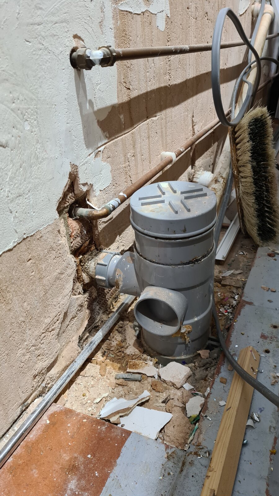

We are trying to fitting a new kitchen.
This waste water pipe is right where we want to put a cupboard. It's the waste for the sink and bathroom water waste.
Can this be lowered?
Is there any other connector that can be used?
Or do we just need to cut a hole in the new cupboard?
Thanks in advance for your help

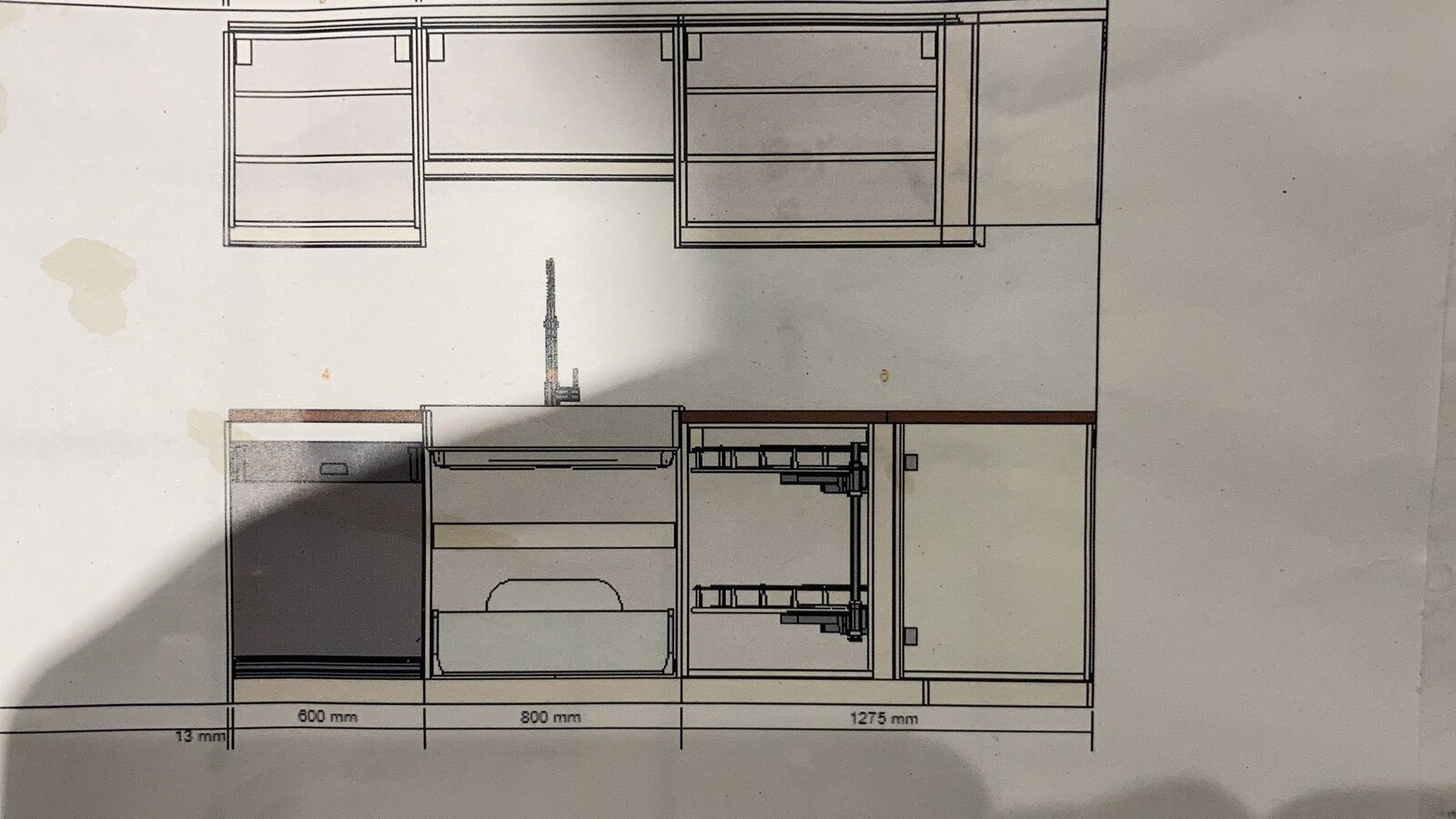

Have you got a plan for the units/appliances on that wall?can you post some idea of whats goin where? ID all existing and proposed wastepipework.
The boss 110mm fitting can be lowwered but it would be a bit of work and expense.Other arrangements with other fittings could work but for me id need far more detail.
What you have seems to be leaking - could you remove the access plug and see whats happening inside at the connections?
How is that branch being held into the pipe in the floor? Almost looks like a banded connection?

This is the plan for the kitchen.
The waste sits where the green mark is so right inbetween where the cupboard is going to be.

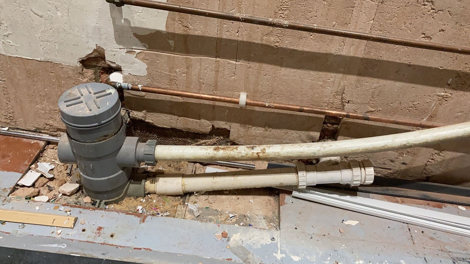

The branch has been cemented onto the old drain. Its sitting in the conservatory so was the old outside drain.
We ve had a look and doesn't seem to be leaking anywhere.

It can be removed and replaced, but you may be opening yourselves up to a whole world of pain if you do so. The boss pipe and cap are glued together, that will only come out in one lump, so its what you're left with afterwards if you try. Ideally, (if that is going to be a habitable room), it wants digging out and the job doing properly, I'd be wary of altering that if, as I suspect, it goes into an old gully.
Currently the cap is removable to provide access if the gully blocks up, replacing it with sealed pipework could be a recipe for disaster down the line.
Thanks for the drawings and new info, they help.
Given the new information and the location of the 110mm what you propose wont work so I'd go with the advice from above and think about digging out an re-working the wastes & water supplies.
As they are they could interfere with the new units and appliances.

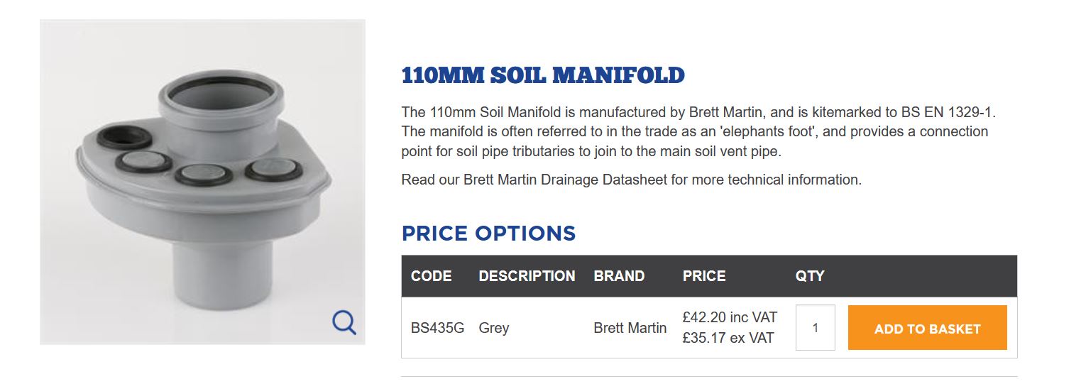

You could dig the floor out and fit a waste manifold flush with the floor, this would keep all the waste connections under the base of the unit.
Apologies OP, didn't notice the other side of the boss with the additional 2 pipes in the original pic. The second pic explains a lot more.
Ignore every I said :whistle:
