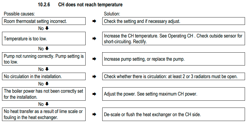

I followed the troubleshooting steps from section 10.2.6 of the manual and increased the pump speed to 90 and the "Starting speed CH" setting to 70, it seems to have helped a bit but the boiler goes quiet again after a minute.
I am leaning towards a pump or condensation issue, what do you think?

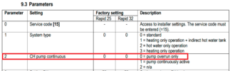

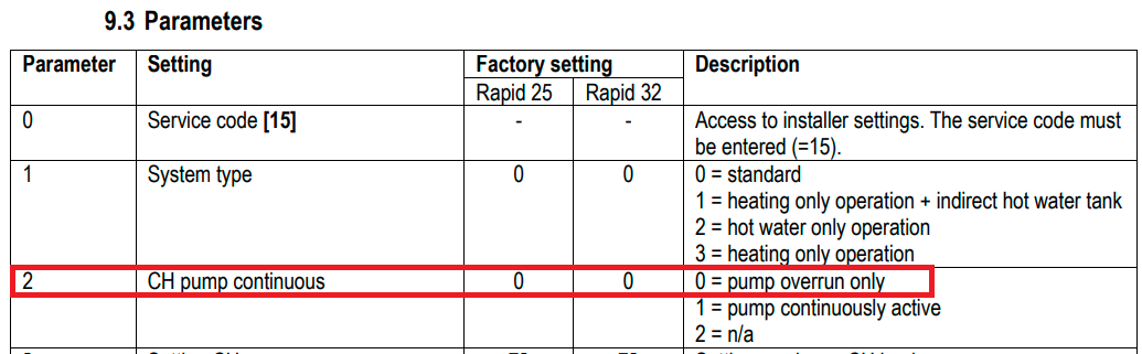

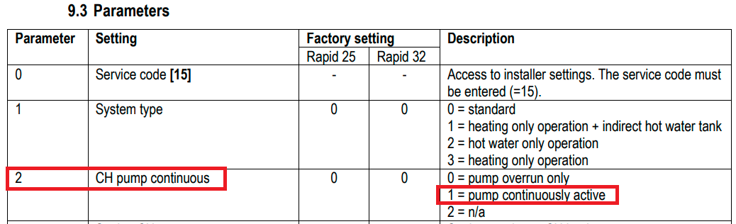

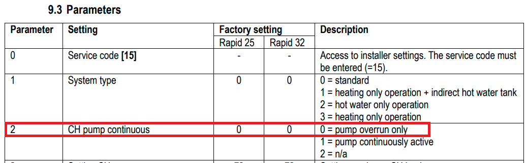

Take the case off. Set the programmer to off then set parameter 2 to 1
Flick it between 1 and 0 a few times and you should hear the pump start and stop
That will run the pump on its own without the boiler firing and you will be able to see and hear if the pumps working (big oblong plastic thingy at the bottom right) without fan noise

Hence I will have to wait until tomorrow 9pm (been doing some tests), but I just found this setting:
which seems to activate the pump, I can hear an additional noise (though as you said, this boiler is very quiet). When I revert the setting to 0, the light noise stops.
On that basis I think I can rule out the pump.
Well spotted, I just came across that setting earlier, it would seem my pump is working (those are pretty quiet by the way). PS: didn't remove the case off though.
