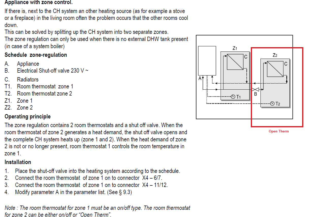

I am about to get a new Intergas Rapid 32 Plus boiler installed. I need 2 zones and my original plan was simply to have 2 zone valves , controlled by my 2 Google Nest Thermostats as On/Off thermostats.
However I came across something interesting page 26 of the boiler manual (refer to screenshot below), it seems I can have the main zone working as On/Off and the second one as opentherm.
I did not know it was possible, I thought opentherm was not possible on multi zones.
I understand that in such scenario I will not be able to control both zones independently (having zone 2 active will automatically activate zone 1), however I struggle understanding how opentherm can work.
If zone 2 is active, does this mean both zone then act as opentherm making thermostat 1 redudant? Effectively meaning it is not really a 2 zones set-up?

Multi zone OpenTherm (I think up to 6) is possible on any OT boiler with EPH controls including DHW.

Use the Honeywell T6R two-zone kit and you can have two independent OT zones through one receiver. It's the perfect match for this application.
You'll need https://theintergasshop.co.uk/honey...rt-thermostat-t6h700rw5001-5025121380027.html
And
https://theintergasshop.co.uk/honey...-wall-mounted-y6h920rw5031-5025121380171.html
Thanks, so I should be able to use opentherm on 2 zones independently using those 2 Honeywell thermostats (instead of my 2 Google Nest thermostats) with 2 zone valves, is that correct? It is a bit annoying I cannot use my Google Nest thermostats for multizone & opentherm...
Regarding the diagram I included in my original post (i.e. the first one), it looks like it will be more expensive to run than having 2 zones with 2 zone valves, would you agree?
