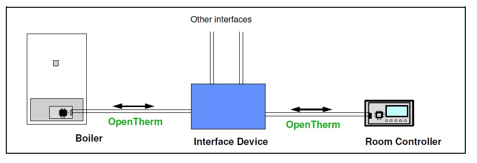

With a bit of research I think I have found the answer
I have under lined the important part of this quote frorn Version 2 of the OpenTherm specification
2.1 System Architecture and Application Overview
OpenTherm is a point-to-point communication system and connects boilers with room controllers, therefore it is not possible to connect several boilers or room controllers
in the manner of bus-based systems.
OpenTherm assumes that the room controller is calculating a heating demand signal in the form of a water temperature Control Setpoint based on room temperature error (or other control form, e.g. OTC) which it needs to transmit to the boiler so that the it can control the output of the boiler. The boiler in turn can transmit fault and system information to the room controller for display or diagnostics. A large number of data items are defined in the OT/+ Application Layer Protocol, covering these and many other pieces of system data.
2.2 Provision for Future Architectures/Expansion
In order to address applications which would normally require a bus-based communications system, it is conceived that intermediate gateways / interface devices
would manage multiple OpenTherm communications lines. In the example below, the interface device acts as a “virtual boiler” to the room controller and acts as a “virtual room unit” to the boiler. In this way, other devices can be addressed while maintaining the basic point-to-point approach.
I assume the blue box has been built into the Intergas Series X boilers.
