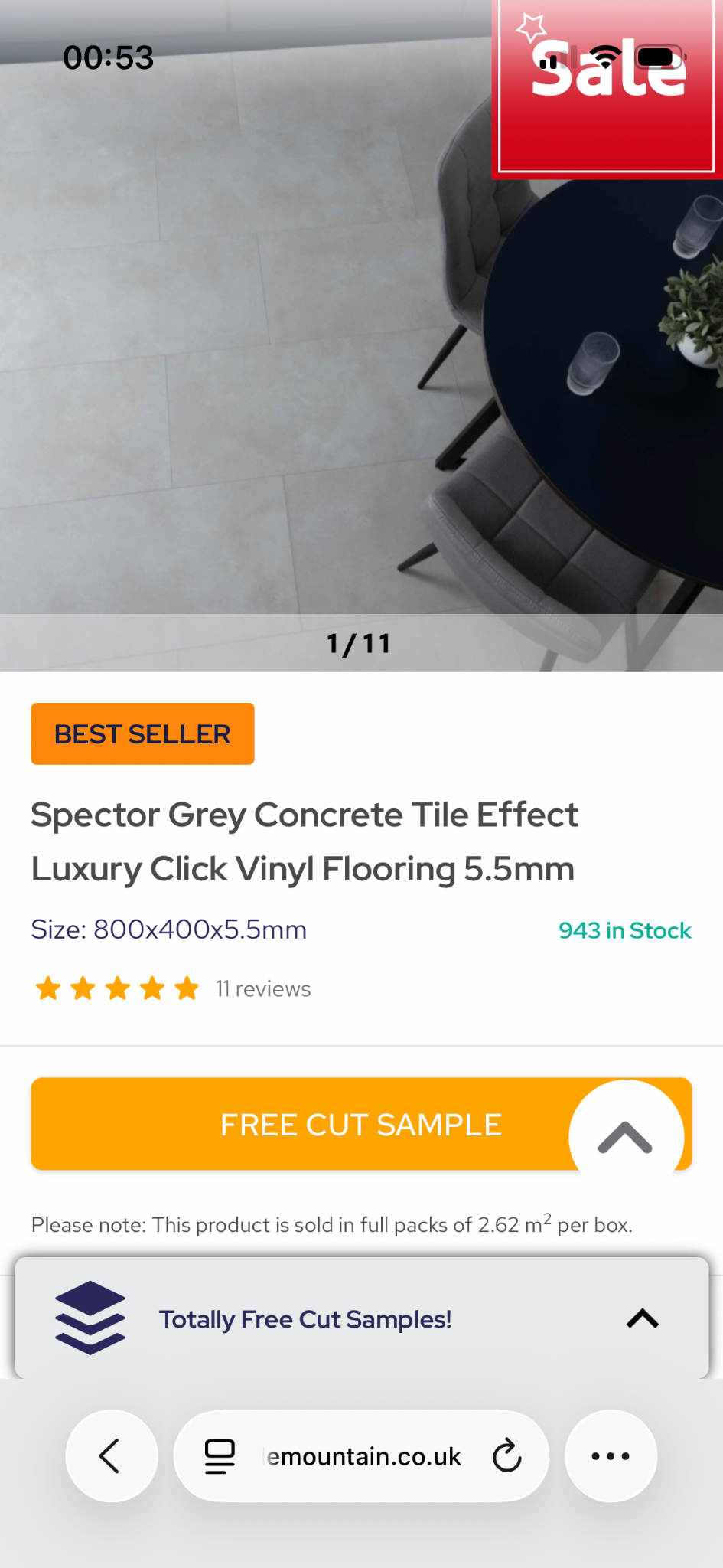

Never had a problem with it, don't get cheap stuff.Why do you think click is bad?
Subjective of course but no match for real wood or nice porcelain tiles. It is plastic based/composite after all. Any click lvt will be also be prone to the click system failing with the slightest of undulations. If it has to be lvt (which I personally don’t think it does) I’d definitely be going for glue down mainly for that reason.Does it look cheap?
That’s my worry because it isn’t cheap at all.
My adhd takes me down a rabbit hole with anything I buy and man maths kicks in.Never had a problem with it, don't get cheap stuff.
Understood.My adhd takes me down a rabbit hole with anything I buy and man maths kicks in.
Trying to keep it in check with this
Decent stuff for less than half that, but tiles will be just fine.Some of this stuff is £80 m2
Understood.
So is it that the feet will sink in over time. The LVT is harder than that isn’t it ?If this is going in a kitchen think about heavy appliances like washing machines and fridge freezers which may cause problems with click LVT.
