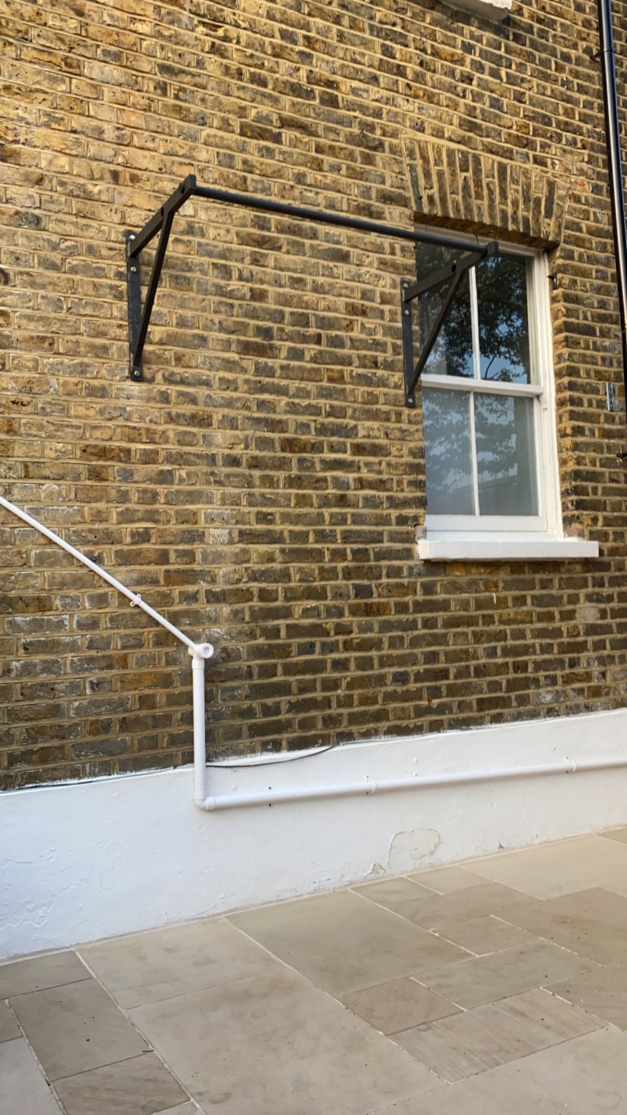

Hey all.
I've been trying to a get pull up bar mounted on the wall outside my flat so I can work out a bit while all this virus nonsense is going on. I've made a right mess of it.

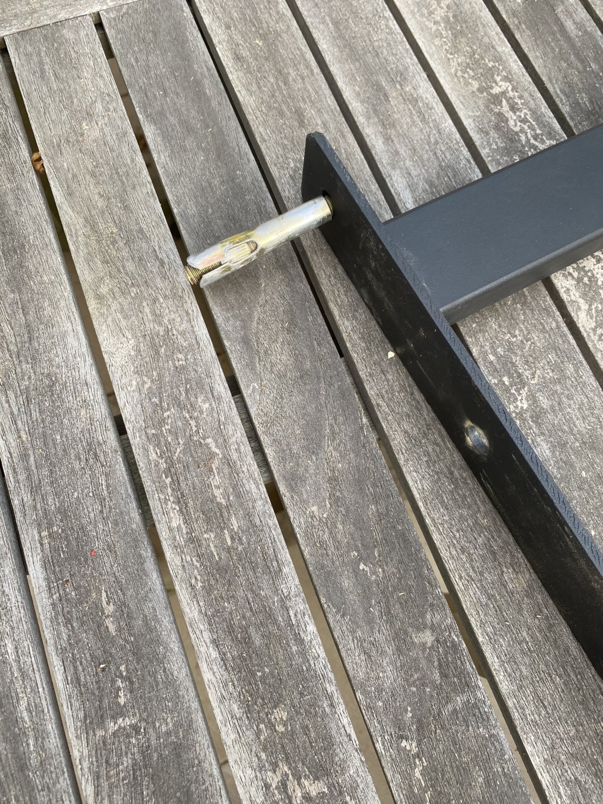

The right hand bracket feels secure (although in my mind in warey of it). I'm not sure if I'm being a total dunce but I have these metal anchor sleeves that came with the bar and I'm inserting them directly into the holes I've drilled into the brickwork.

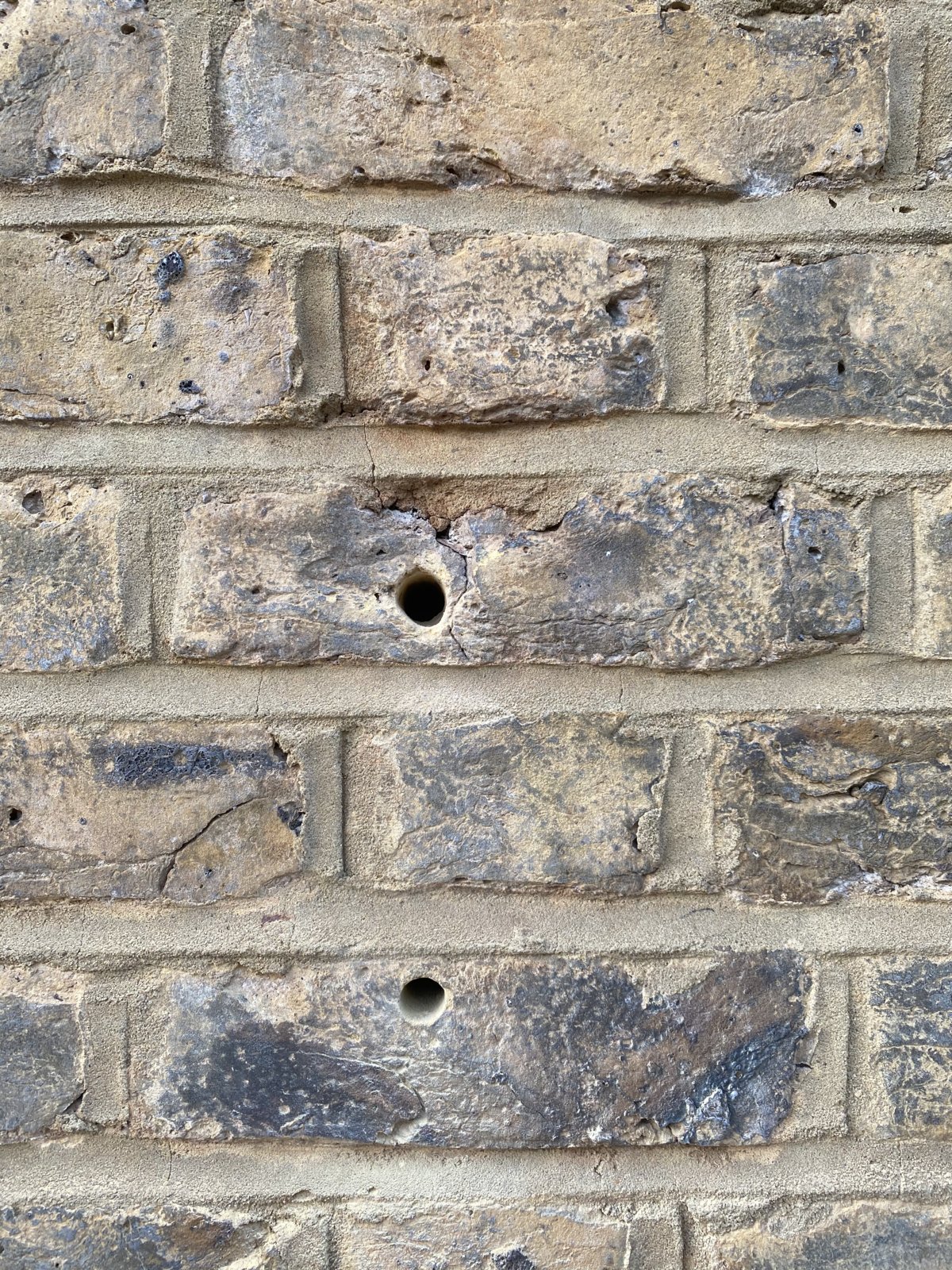

The left bracket has not gone well. The top hole, when I came to drill it, went into the brick like butter, and now the hole is too loose. I got the bar up and hoped that even though the top hole was probably not solid, i hoped the sleeve would expand enough to get some purchase, and i hoped the bottom two were good enough to hold it overall.
But after giving it a good test yank, it did indeed come loose. Can I recover these holes and make them strong? Should I be buying some larger plugs? Should I be hammering wood into the holes? Or plastic plugs? Should I fill the top hole and redrill it? I'm totally clueless.
Pictures attached.
Cheers, Charlie

You'd be better having the thing a bit further away from the window as well, there's a good chance you'll pull a brick or 2 out. Is that a communal area and/or is your flat leasehold. If either answer is yes you can expect some grief from your landlord/leaseholder.
EDIT Yes chemical anchors are the way to go. Dynamic load is rule of thumb double the static load- so if you weigh 100kg you're putting 2 kiloNewtons into that bar which gives some major pull on the top fixings.

Yes do all 6. Risk of bricks pulling is lower with chemical anchors (you're not using an expanding piece of metal) but the holes have to be the correct diameter, they have to be clean and you have to be fairly quick.
Those anchors do look fairly pathetic though again they might do the job if your wall is dead flat, the holes are the correct diameter and you don't end up in a mortar course or in a brick frog. With the resin jobs, you need to be careful how deep you drill the holes- if you go through the outer skin there's a risk the resin will just drop out the back of the hole. Again resin won't work particularly well in a mortar course.

Also, I'm trying to make the right call on the type of stud to buy. The threading on the sleeve anchors I was provided with is about 80mm long, and so the holes I've drilled is about to that depth. The holes I've drilled are probably just over 12mm wide (the worst hole maybe more like 14mm). I think I read a suggestion that the hole is to be approx 4mm wider than the rod. Given all that it sounds like probably want these?
https://www.toolstation.com/a2-stainless-chemical-stud/p62545
Some studs have a break in the threading. I'm not quite sure what that's about but feels like it may make things more complicated for me? The studs above are just plain threaded which feels like I can't go far wrong in terms of getting the depth insertion right...
The hole diameters are definitely not going to be perfectly to specification, but reading some of the specs about what kind of loads these anchors can hold, I'm thinking I'll be ok if the stud in the looser hole has a bit more resin around it than would be ideal, or am I really playing with fire here? Guess I'll find out...

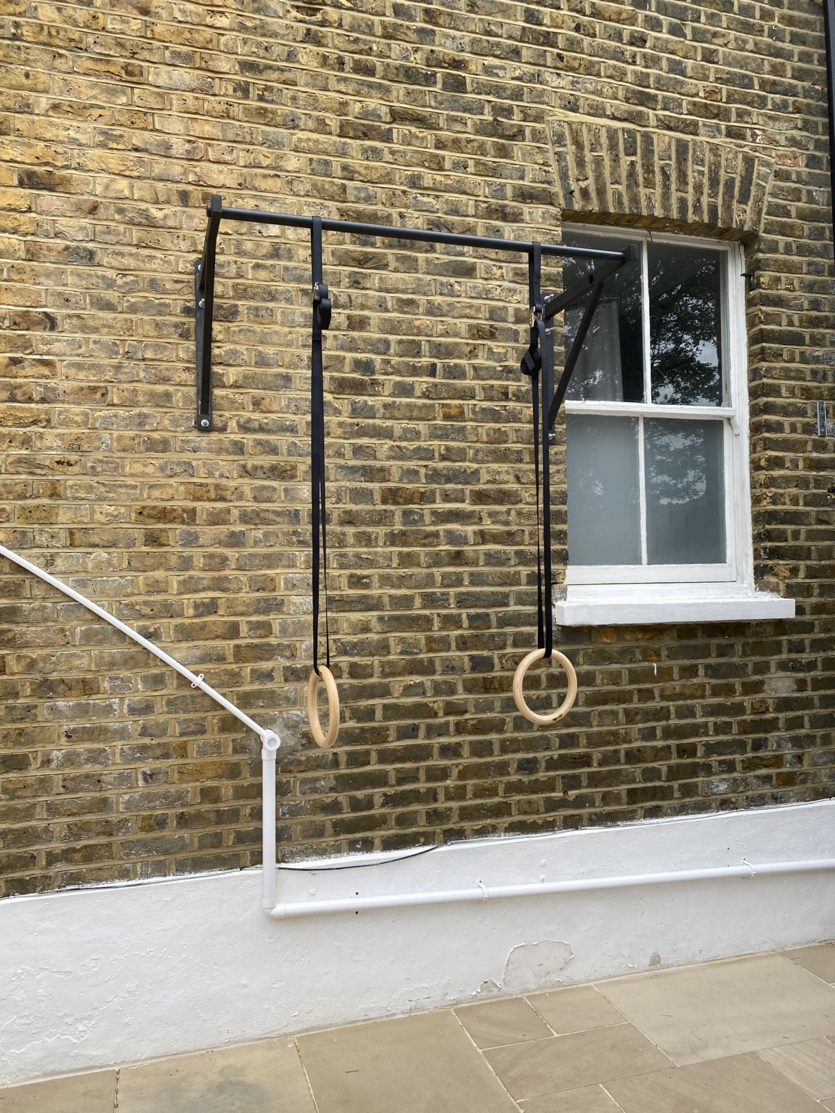

Just wanted to say thanks for the useful advice! Resin, threaded rods, and a few washers around the back to "shim it up" has worked well. It feels solid, even with a dynamic movements.
Hopefully it'll hold and I won't pull a brick. (I'm not doing any crazy inversions on those rings or anything).
Cheers, Charlie.
