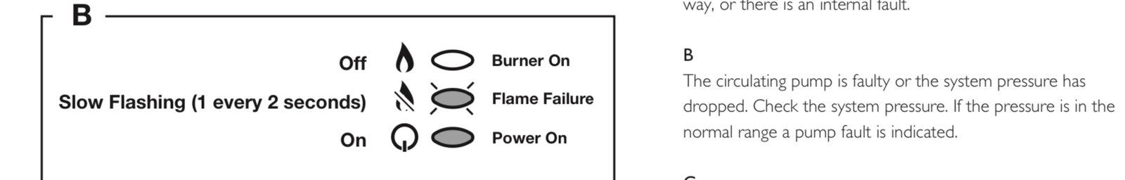

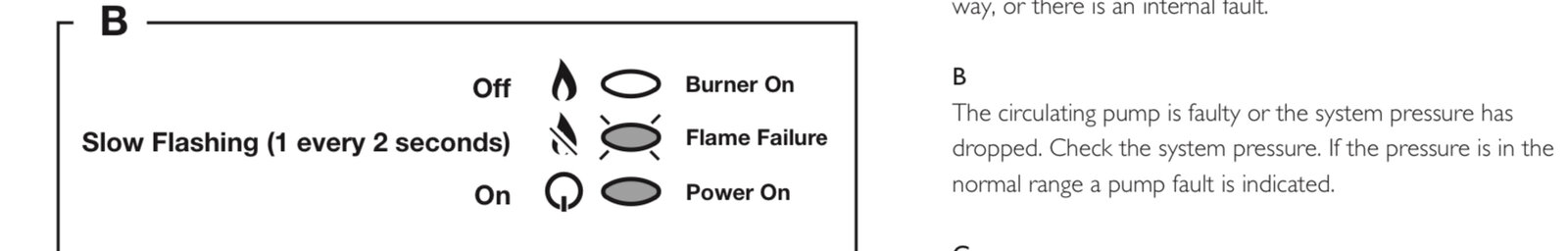

If it’s the same as this (photo) then suspect the pressure or circulating pump.
@gas112 or @ianmcd might be able to confirm this.

Hi Chris,
Thanks for your reply, the system pressure is good and I suggested a pump issue to the Baxi engineer after looking at the same troubleshooting page as you. He dismissed it as the heating works if there is a call for heat when the boiler is first switched on.
