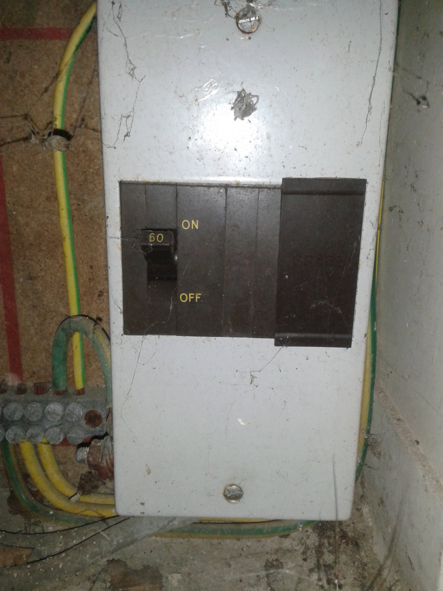

main fuse tripped
If it was a metal back box it may be just the live screw has come into
If it was a metal back box it may be just the live screw has come into contact with it.
Yep im pretty sure that's what happened
Check out the metal tab at the top of the box... its all scorched
It is positioned right above the live screw so
Ive removed that tab

This is the thing that tripped in the meter box.

I'd just knock both the top and bottom lugs back with a hammer and punch/chisel so they are flush with the box as they are not needed.
