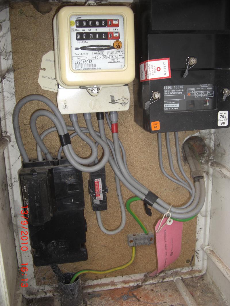

I am trying to understand the arrangemnt in my main incoming supply. Could some please explain the following:
1. Why is the main service 60A fuse is not sealed.
2. Why do I have a 32A sealand fuse to the right of the main service fuse, what is this for.
3. What is the black box to the right of the meter.
4. I am used to seeing just a main L & N supply going into a meter and from there tails going into the CU, but do not understand this one in the picture.
5. Is it possible to get the DNO to rip this out and just install a standard meter with a DP switch disconector in the tails.
Thank you
That's a white meter.It has the ability to record low tariff usage as well as standard.
The low tariff is controlled by the black unit on the right, a teleswitch, which will switch you over to the low rate overnight.
If you use a lot of electricity overnight, this set-up makes sense. Lots of folk put the dishwasher / washing machine etc on during this time to take advantage of the low rate.
White meters are also common in properties which have storage heaters. These are energised overnight on the low rate and let out the heat during the day.

It is NOT a white meter (well, ok, its coloured white).
It is a DUAL RATE METER.
White meters typically refer to the old white tarrifs where you had one rate for standard electric 24/7, and a switched supply during the night for use only with storage heating which would have it's usage recorded on a 'white meter'. Only the storage heaters would use cheap lecky.
A dual rate meter is used with the tele-switch to provide cheap rate electric to the entire installation.
