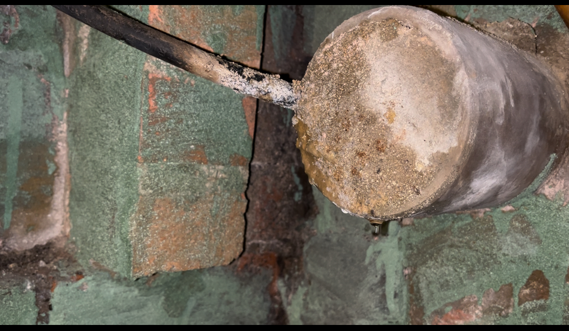

Hi
I’ve recently reopened the old coal cellar under my house and can see the mains cable from the street coming in underground. It’s entering the property by a large clay pipe (similar diameter to a main soil pipe) which has effectively been concreted up at the end except for the mains cable poking through.
The problem I’ve observed is that it appears to be channeling water into my basement as it’s leaking around the cable and when it rains it’s dripping quite badly. I assume the clay pipe extends out to the street but don’t actually know what is happening in my front garden/it’s all paved.
My question is who is responsible for the clay pipe the cable is contained within? Clearly the cable is the responsibility of the electricity company but are they also responsible for the conduit that brings it into my house? It’s brining in enough water for it to be a material problem.
Interestingly the mains water is also coming in at a similar depth where there is just a half brick missing and no water is coming in for that hole, so does feel like it’s being channeled from further away. I’ve also turned my mains water off, checked the main supply line into the house isn’t leaking as the meter isn’t going down.
Any advice appreciated
Thanks!

Phone the electric company. They installed so their problem.
You need a new cable fitted and that clay pipe removed.

I doubt the electric company fitted the duct.
Maybe. Worth asking though just to find out where you stand.
Other option is to dig down on outside and block off yourself if electric company is not responsible
I'd say any involvement with supplier would very likely result in them moving the head/meter, at a price, to the meter box outside, provided by customer.

I suspect that the "pipe" may be "asbestos cement" and not "clay".
However, I am sure that you will be able to find a "product" which can be applied to the wet cement within that pipe to stop the flow of water into the "coal cellar".
(e. g. https://www.amazon.co.uk/weather-sealant-seals-under-Aquafix/dp/B005T2TUCS/ref=sr_1_4?crid=Q42VB9WU8C1W&dib=eyJ2IjoiMSJ9.fkz6Fxl1PySb0L4afPyN9XJglMP_sAJkLVF-kEX0XuhHkWxVDNH5usC_v03p18Djc8IEI4Xao11cAUEWdhT4YF7eHTnuWv3CmzoSisoSOnN5SxON-l4YAcnjKw5ISzSinA4PN1tvMhIondmasVMN37UUsofHrKdvt0v-hWKyGZGkqHaMwEpBCDilX59E-sO3vOsm8Gu42Ni67t30Q8dRfMgfliOx_HBpkNEQh8CRs3EQbt_EuBAjgR1Vy2th0qfg07VEDidCGanmy0G-_MbmJLicnBIESqZoHVexLcmyUK8.Ymbd3vH3TkdGywhQr2CzlcAeSavUWxpNm49hjmUdSo8&dib_tag=se&keywords=wet+cement+seal&qid=1716527913&sprefix=wet+cement+seal,aps,430&sr=8-4 )
It may be necessary to chip away about 10 mm of "cement",
"seal" it
and
then apply something else (such as an Acrylic Sealer) on top
to completely stop moisture ingress.
(Silicone should be avoided !)

If you seal the pipe at the cable end, then that cable will be sitting in water constantly you need to stop the entry of water into that pipe.
Well yes, it could be some benefit.
If you are in a boat you would not think of drilling a hole in the bottom to let the water out!

That insulated cable seems to have been "sitting in water constantly" for many years - to no harmful effect - so far!
Frodoone Not been sitting constantly in water as its leaking out . Not good practice to leave any cable even a SWA immersed in water constantly
My thought would be that you have the same problem as me (not tackled yet). The real issue is water outside the house is not draining away from the house walls. This is therefore a drainage issue. The solution I am thinking is to get the drainage working via soakaway or to the waste drainage system.
