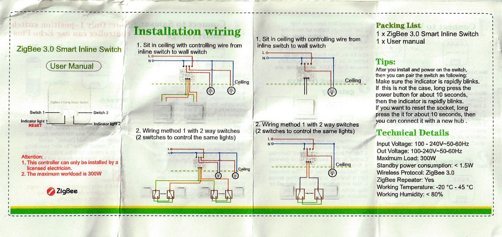

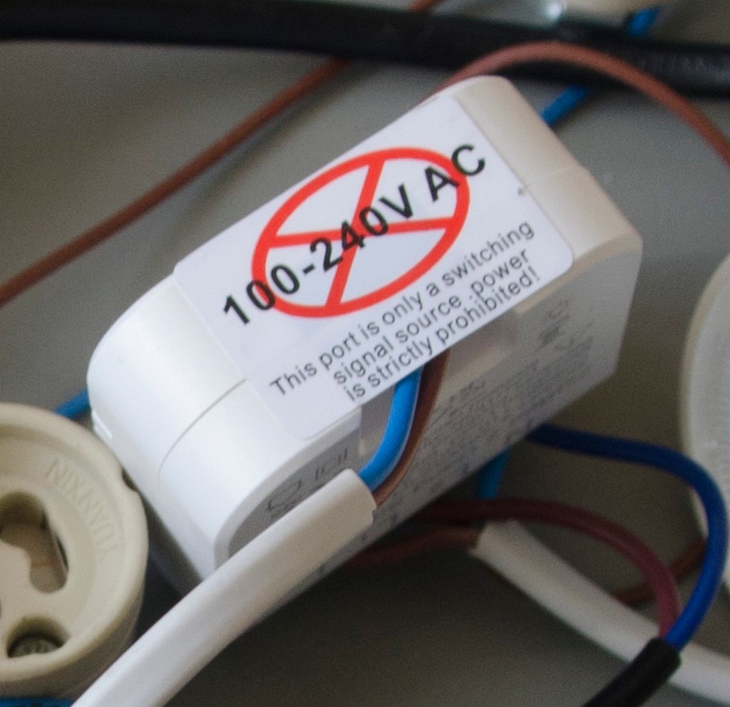

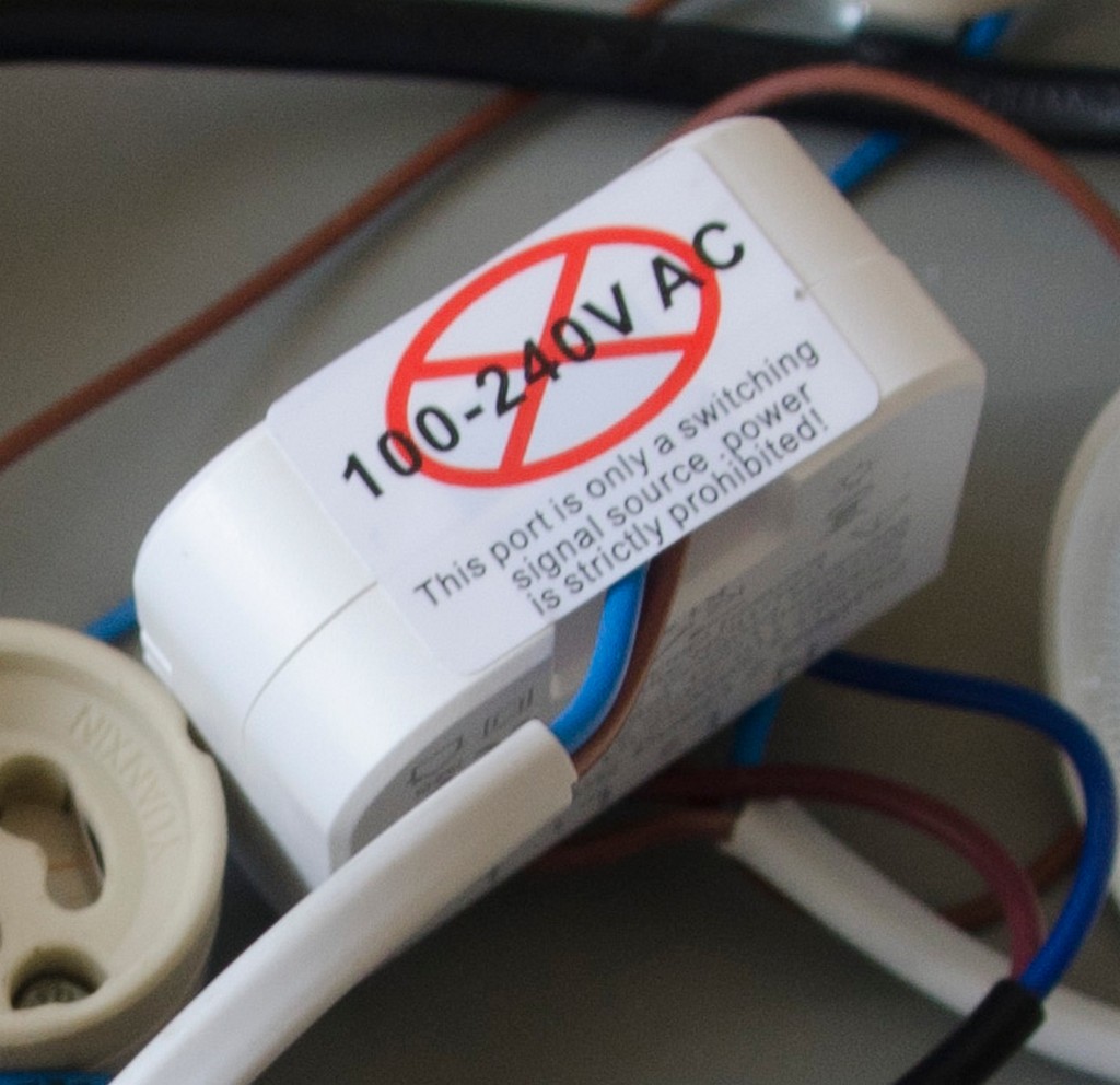

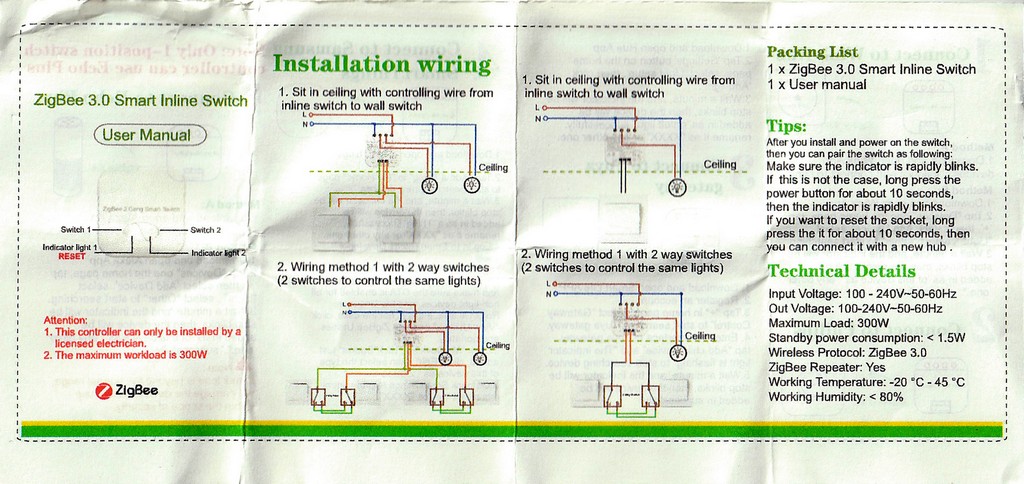

I found a relay rated 300 watt DSC_6062.jpg which I am using for lights, wonder if you can get a larger version? What I wanted was the standard light switch to work and also the phone so both work like a two way switch.
Instructions Landing-light-relay-instructions2.jpg Landing-light-relay-instructions1.jpg as said seem you want a larger version of the same.
