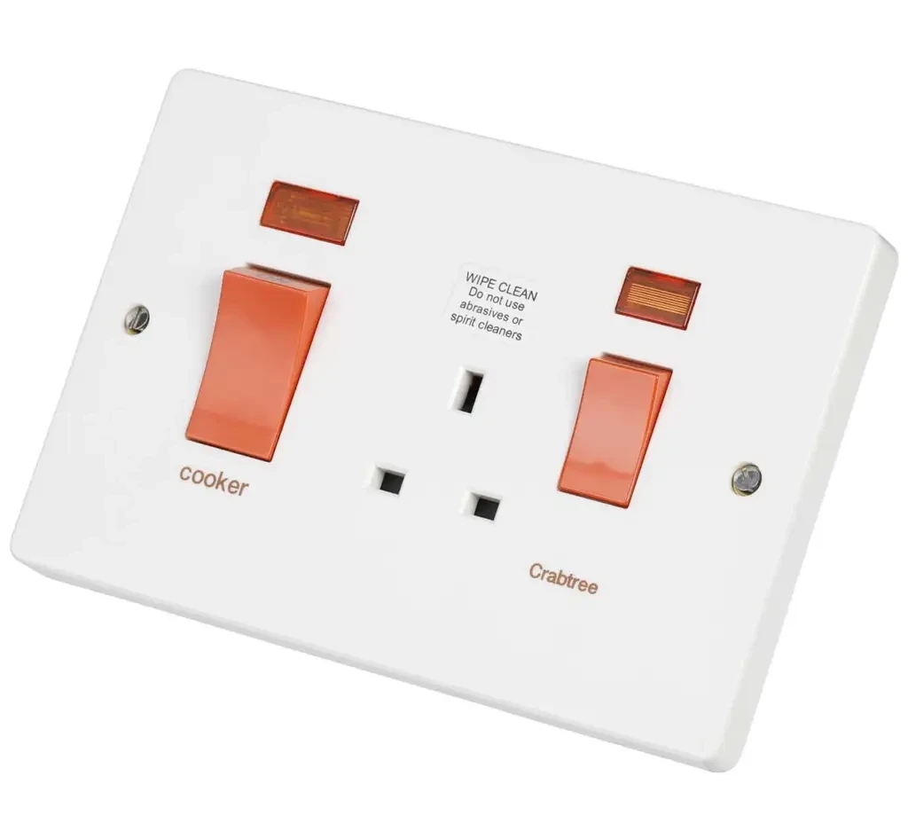

I have several Crabtree switches with indicator neons that have gone black. I can still get replacements, but I'm hoping there is a source of LEDs that will last longer and perhaps be brighter.
The neons have an integral resistor and long tails, "bulb" is 6mm diameter and about 20mm long
Does anyone know a source?
Thanks in advance

Ah yes, that 's a panel lamp, not quite what I need.
It's to go in these, to fit in clips behind the windows
Yes, I bought something like this for an indicator for my boiler wiring centre, and you could pull out the led from the mount, but there's no guarantee. Sorry, I just looked for one of them to see but it has long disappeared.
